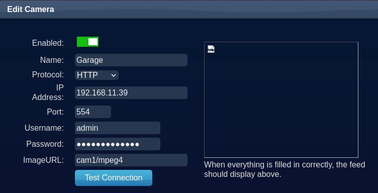

I have successfully setup the CAM with AgentDVR. The connect URL is: rtsp://192.168.11.39:554/cam1/mpeg4.
In domoticz I have tried this
without success. I also played unsuccessfully around with different variations.
Any hints how to proceed?

Best is to check if your camera supports a snapshot mode as that is supported in the image URL. eg http://192.168.11.39/cam1/snapshot (fake URL!)
In this wiki page you have some examples: https://www.domoticz.com/wiki/Camera_Setup
Edit: check grab.jpg?oid=1 and command.cgi?oid=1&ot=2&cmd=snapshot from https://www.ispyconnect.com/userguide-agent-api.aspx
