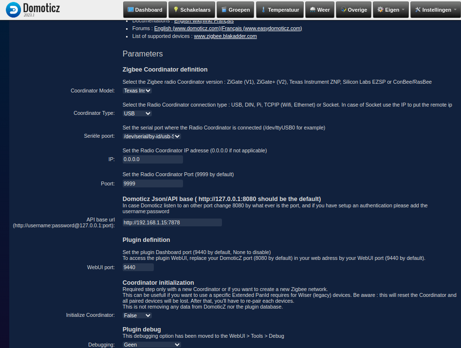

Dear forum members,
I'm on my test raspberry to make a clean install with Bullseye and Domoticz.
Unfortunately with zigbee4domoticz I have an error that I can't get out of.
Port forwarding is on
What am I doing wrong?
I have tried all my ip addresses and ports but I keep getting an error.
Z4D log
Domoticz log
Z4D log
10: Object {"0":{"Time":"19/02/2023 23:13:36","Module":"DZDB","nwkid":"None","PluginHealth":"Startup","message":"Urlopen to http://127.0.0.1:7878/json.htm?type=hardware rejected. Error: HTTP Error 401: Unauthorized","PermitToJoin":{"Duration":0,"Starttime":1676844851},"Thread":"MainThread"},"1":{"Time":"19/02/2023 23:13:36","Module":"DZDB","nwkid":"None","PluginHealth":"Startup","message":"Urlopen to http://127.0.0.1:7878/json.htm?type=hardware rejected. Error: HTTP Error 401: Unauthorized","PermitToJoin":{"Duration":0,"Starttime":1676844851},"Thread":"MainThread"},"LastLog":1,"StartTime":"19/02/2023 23:13:36","FirmwareVersion":"Z-Stack 3.30+ (build 20220219)","FirmwareMajorVersion":"20","PluginVersion":["stable6-6.3.010"]}
11: Object {"0":{"Time":"20/02/2023 15:12:11","Module":"DZDB","nwkid":"None","PluginHealth":"Startup","message":"Urlopen to http://127.0.0.1:7878/json.htm?type=hardware rejected. Error: HTTP Error 401: Unauthorized","PermitToJoin":{"Duration":0,"Starttime":1676902366},"Thread":"MainThread"},"1":{"Time":"20/02/2023 15:12:11","Module":"DZDB","nwkid":"None","PluginHealth":"Startup","message":"Urlopen to http://127.0.0.1:7878/json.htm?type=hardware rejected. Error: HTTP Error 401: Unauthorized","PermitToJoin":{"Duration":0,"Starttime":1676902366},"Thread":"MainThread"},"LastLog":1,"StartTime":"20/02/2023 15:12:11","FirmwareVersion":"Z-Stack 3.30+ (build 20220219)","FirmwareMajorVersion":"20","PluginVersion":["stable6-6.3.010"]}
12: Object {"0":{"Time":"20/02/2023 15:37:30","Module":"DZDB","nwkid":"None","PluginHealth":"Startup","message":"Urlopen to http://127.0.0.1:8080/json.htm?type=hardware rejected. Error: <urlopen error [Errno 111] Connection refused>","PermitToJoin":{"Duration":0,"Starttime":1676903882},"Thread":"MainThread"},"1":{"Time":"20/02/2023 15:37:30","Module":"DZDB","nwkid":"None","PluginHealth":"Startup","message":"Urlopen to http://127.0.0.1:8080/json.htm?type=hardware rejected. Error: <urlopen error [Errno 111] Connection refused>","PermitToJoin":{"Duration":0,"Starttime":1676903882},"Thread":"MainThread"},"LastLog":1,"StartTime":"20/02/2023 15:37:30","FirmwareVersion":"Z-Stack 3.30+ (build 20220219)","FirmwareMajorVersion":"20","PluginVersion":["stable6-6.3.010"]}
13: Object {"0":{"Time":"20/02/2023 15:39:46","Module":"DZDB","nwkid":"None","PluginHealth":"Startup","message":"Urlopen to http://192.168.1.15:8080/json.htm?type=hardware rejected. Error: <urlopen error [Errno 111] Connection refused>","PermitToJoin":{"Duration":0,"Starttime":1676904018},"Thread":"MainThread"},"1":{"Time":"20/02/2023 15:39:46","Module":"DZDB","nwkid":"None","PluginHealth":"Startup","message":"Urlopen to http://192.168.1.15:8080/json.htm?type=hardware rejected. Error: <urlopen error [Errno 111] Connection refused>","PermitToJoin":{"Duration":0,"Starttime":1676904018},"Thread":"MainThread"},"LastLog":1,"StartTime":"20/02/2023 15:39:46","FirmwareVersion":"Z-Stack 3.30+ (build 20220219)","FirmwareMajorVersion":"20","PluginVersion":["stable6-6.3.010"]}
14: Object {"0":{"Time":"20/02/2023 15:42:25","Module":"DZDB","nwkid":"None","PluginHealth":"Startup","message":"Urlopen to http://192.168.1.15:7878/json.htm?type=hardware rejected. Error: HTTP Error 401: Unauthorized","PermitToJoin":{"Duration":0,"Starttime":1676904177},"Thread":"MainThread"},"1":{"Time":"20/02/2023 15:42:25","Module":"DZDB","nwkid":"None","PluginHealth":"Startup","message":"Urlopen to http://192.168.1.15:7878/json.htm?type=hardware rejected. Error: HTTP Error 401: Unauthorized","PermitToJoin":{"Duration":0,"Starttime":1676904177},"Thread":"MainThread"},"LastLog":1,"StartTime":"20/02/2023 15:42:25","FirmwareVersion":"Z-Stack 3.30+ (build 20220219)","FirmwareMajorVersion":"20","PluginVersion":["stable6-6.3.010"]}
LastLog: 14
2023-02-20 15:12:11.879 Error: Z4D: Urlopen to http://127.0.0.1:7878/json.htm?type=hardware rejected. Error: HTTP Error 401: Unauthorized
2023-02-20 15:12:11.890 Error: Z4D: Urlopen to http://127.0.0.1:7878/json.htm?type=hardware rejected. Error: HTTP Error 401: Unauthorized
2023-02-20 15:37:30.278 Error: Z4D: Urlopen to http://127.0.0.1:8080/json.htm?type=hardware rejected. Error: <urlopen error [Errno 111] Connection refused>
2023-02-20 15:37:30.290 Error: Z4D: Urlopen to http://127.0.0.1:8080/json.htm?type=hardware rejected. Error: <urlopen error [Errno 111] Connection refused>
2023-02-20 15:39:46.586 Error: Z4D: Urlopen to http://192.168.1.15:8080/json.htm?type=hardware rejected. Error: <urlopen error [Errno 111] Connection refused>
2023-02-20 15:39:46.594 Error: Z4D: Urlopen to http://192.168.1.15:8080/json.htm?type=hardware rejected. Error: <urlopen error [Errno 111] Connection refused>
2023-02-20 15:42:25.815 Error: Z4D: Urlopen to http://192.168.1.15:7878/json.htm?type=hardware rejected. Error: HTTP Error 401: Unauthorized
2023-02-20 15:42:25.825 Error: Z4D: Urlopen to http://192.168.1.15:7878/json.htm?type=hardware rejected. Error: HTTP Error 401: Unauthorized

I guess you have a problem which is related to the new security fashion from Domoticz.
So you have to have the IP address to be on the "trusted IP list" from Domoticz

Re: [Zigbee4Domoticz Plugin] new version annoucement
I had some problems with this as well, had multiple IP addresses in the trusted networks field.pipiche wrote: Tuesday 21 February 2023 19:34 I guess you have a problem which is related to the new security fashion from Domoticz.
Found out that they should be separated by a semicolon, and NO spaces! (I had originally inserted a space for readability)
It now works OK.
Hans
Hoi pipiche,pipiche wrote: Tuesday 21 February 2023 19:34 I guess you have a problem which is related to the new security fashion from Domoticz.
What I have now entered is,
login name(domoticz):password(domoticz):IP address(domoticz):port(domoticz).
Still the same error.
The plugin does work, I can add parts and they work well.

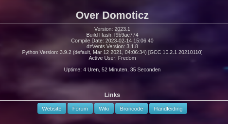

Domoticz 2023.1 requires https if the IP address is not trusted. from what I saw in your log you are using only http, so make sure that the IP are Trusted.

Or if the plugin is using Basic Authentication over http (and not https) you need to enable it in the security section.
But it is more secure if you would do things over https instead of http.
