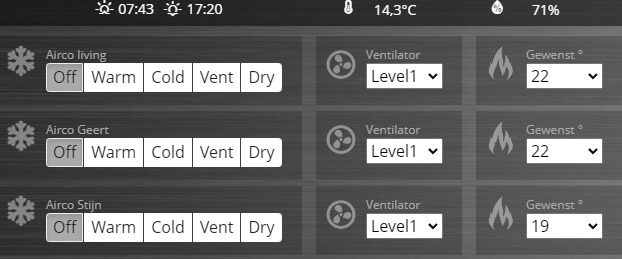

Re: Dashticz v3.9.6 Beta
some devices don't render properly anymore.
should look like
These are 'selector' switches in Domoticz for MELCloud (Mitshubishi AirCo), but the same problem with selector on Dummy hardware
should look like

Lokonli
- Posts: 2296
That's strange.
From a certain Domoticz version onwards the switch levels became encoded. The version detection doesn't seem to work correctly anymore.
What is the exact Domoticz version as reported in Dashticz?
(click on the Cog icon in the upper right of the Dashticz window, then on info tab)
Do you also have this problem with a Windows browser?
If yes, can you open DevTools (press F12), refresh Dashticz. Are there any errors reported on the Console tab of DevTools?
geertvercamer
- Posts: 84
- Joined: Friday 12 May 2017 20:03
- Target OS: -
Yes, I did clean the cash.
Dashticz 3.9.6.1 beta reports Domoticz version 2022.1
Tried Edge, Chrome, Brave browsers on W10, all the same

Lokonli
- Posts: 2296
I think I've found, and fixed, this bug.
Can you test latest beta?
Update with:
Update with:
git checkout beta
git pull

geertvercamer
- Posts: 84
- Target OS: -
Confirmed.madpatrick wrote: Saturday 05 November 2022 14:43 Yes !
It is working again.
Thanks for the quick fix
