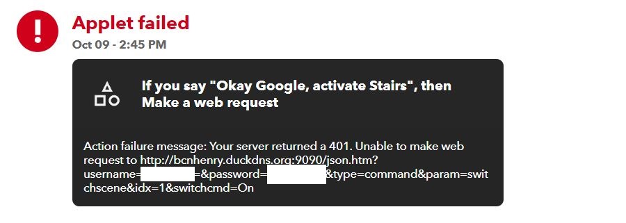

Hi everyone..... Trying to make my google mini to trigger a scene. Before it worked. But since ifttt/google assistant changed (2ys ago aprox) stopped working. I tried to recreate, but do not stop getting errors.
if I open the URL in a browser, I get:
"status" : "OK",
"title" : "SwitchScene"
But if I trigger from google home, I get the error: Any idea what I am doing wrong?
"status" : "OK",

Hello
Since 31/08/2022 the integration of IFTTT with google has changed and it is no longer possible to perform the action you mentioned with a parameter.
I moved from IFTTT to a DZGA Domoticz Google Assistant solution successfully.
BR
BR

The 2nd one now works. I realized that on SCENE ICON, I did not have the "scene reversible" ticked. Now I can turn on/off nicely
Tks again for the huge help! It is really much simpler than any other solution!
- FireWizard
- Posts: 1968
- Location: Voorthuizen (NL)
Re: ifttt -> google assistant. Any easier way to use it to turn on/off lights?
Hi, @henrybcn,
You wrote:
Probably I did not include that, because it might cause confusion, as it contains my own configuration.
And of course, if you want to reverse the scene, you have to tick that box.
You wrote:
That is correct. There is no MQTT Output node connected (which contains the topic domoticz/out)The first one is what you sent me. It triggers rednode, but does not reach domoticz. I guess it is because there is no domoticz in/out
You can omit the JSON node, as it is not necessary. The output from the "Function" node is already JSON.The 2nd one now works. I realized that on SCENE ICON, I did not have the "scene reversible" ticked. Now I can turn on/off nicely

Tks again @FireWizard!
All set!
All set!
