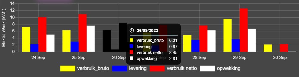

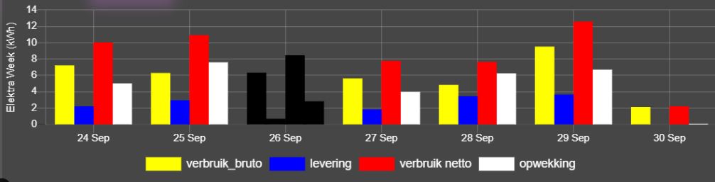

I've have a strange behavior with my graph. I've combined my P1-meter sensor and my solaredge modbus sensor in one graph. When I select (tooltip) the graph, it combines data of the solaredge sensor with the data of the p1 meter from the day before. See attachment.
Anyone any ideas?

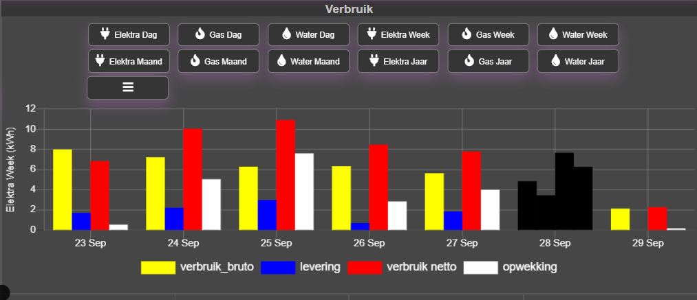

Solved.
Since not all the data from the entire week was complete yesterday (22 sep was not filled in), it is very likely that this is why the problem occurred.
As you can see, my graph is now working as expected. It combines all sensors from the same day.
- Knipsel3.JPG (54.61 KiB) Viewed 750 times

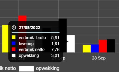

Nice. Just curious: Do you know why you have black bars?michelscholte wrote: Thursday 29 September 2022 9:30 Solved.
michelscholte
- Posts: 75
- Joined: Friday 08 January 2016 10:02
- Location: Nederland
Re: Graph combined behavior
Its only the first click on the graph and no tooltip is showing. After the second click on the graph I see the the tooltip with a graph with black bars. Then when I click on the tooltips popup, the bars are in color. I don't know why?
