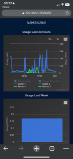

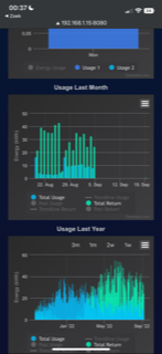

Hello!
I moved my domoticz db from a dedicated raspberry pi to another one on docker. No problems, but one..
Since the day i moved the database there is no history written from the p1 sensor.
I see actual values, I see the last 24h of 5 minute data, but when the clock goes to 00:00 normally the 5 minute data is converted to a day in the last week, last month and last year graph. This does not happen. At 00:00 the history graphs, as well as the reports stay empty. When i check the db manually there is just no line written in the multi-meter-calendar db..
The gas usage from the same p1 sensor is normally logged. As well as all other sensors. Only this electricity one refuses to log history.
I see absolutely no errors in logs, no corrupted db, no strange values in db.
Tried docker containers domoticz:stable and domoticz:latest with no difference.
Another one with the same problem here: viewtopic.php?t=37279
But i do nit have sql errors so i think the cause of my error is another one.
Somebody with an idea? I am alteady missing two weeks of data now :-(
