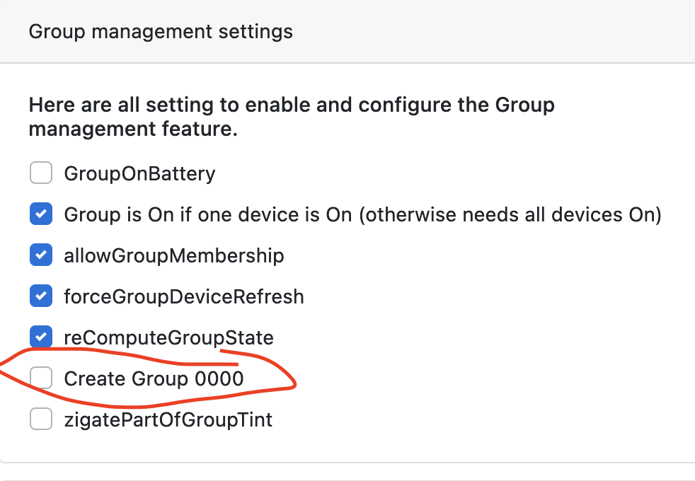

pipiche
Posts: 2027
Re: Sunricher ZG2858
Post by pipiche »
Thanks for all those information. Indeed I did the test some times ago and that should work. UNfortunatly I don't have the device with me at that time to test it.
I wonder if the Group 0000 should nbot be created.
Can you try that ?
Screenshot 2022-09-14 at 10.35.13.png (102.26 KiB) Viewed 919 times
julienb
Posts: 13
Joined: Friday 13 May 2022 7:57
Post by julienb »
Thanks for your support.
I tried that (enabled groups, they were not, checked the create group 0000, rebooted domoticz), and repaired the device. I still get the same behaviour. Group 0000 shows up correctly in group management page. No device in this group, i put one, and could see it created in domoticz (one of the lights i want to control), but i can't put the remote in the group (only routers).
Any ideas or logs i should enable ?
