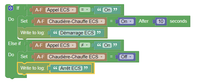

Re: How-to: launch action after a certain time
Finally I found out a dummy solution without dummy switch...

What if someone opens the hot water tap for 25 seconds? And again, and again? Eventually it would leave the boiler cold!
I know it may sound unlikely, but you should code for the worst...

Good point,
I found a thread about that, see viewtopic.php?t=33002
Unfortunately dz.emitEvent('myEvent').cancelQueuedCommands() doesn't work but it describes some work-around solutions.
