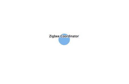

Hi All,
After apply this https://zigbeefordomoticz.github.io/wik ... ion-6.html to run with stable 6 version of plugin
All zigbee device was communicate with domoticz.
But on network Topology, I couldn't see the graph.
On web interface Zigate I read 'Activer si besoin l'option displaySibling'
but not visible in setup.
Thanks for your help
network topology not visible

did you solve this issue ?
I have exactly the same issue with the last. release of Domoticz and plugin with no error in the log.
Thanks for any help

I had the same issue with Zigate+ and the last firmware 3.A0: no topology and devices set as "not reachable" in the main dashboard.
Issues solved by downgrading the firmware of the Zigate+ key to Version 3.22.

Me too, firmware ZiGatev2-3A0.bin is not a good firmware, I loose several devices being unreachable. Back at 322 all is OK.
