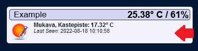

Is it possible to make temperature sensor's widget background color change when temperature changes above or below certain threshold? For an example, background goes red when sensor's temperature exceeds certain value.
I would like to know if it can be added and in the case if it could be added, then how? I ain't much of a coder, so examples are very appreciated.
Thanks in advance for all answers!
P.S. I have put an image with an red arrow in it as additional information, just in case.

This is not possible. There is no function in Domoticz to set a background for a specific device nor on specific values.
You can send (popup/email/telegram/sms etc) notifications on specific values/thresholds with the notify button See wiki https://www.domoticz.com/wiki/Managing_ ... ifications
To add a function for changing background color will have to be a major change as it also needs to have to store the threshold values.
Perhaps it could be an addition to the notification functionality to change the widget background color?
