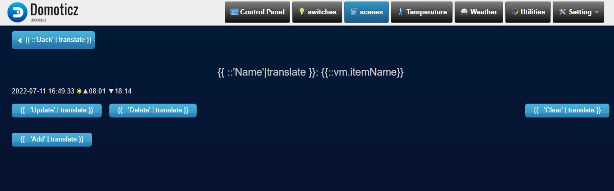

I am using Domoticz 2022.1 and I find that when I go to scenes and then go to the schedules option, the buttons are broken as I show in the attached image.
Any suggestion?

I have this sometimes when I switched from my test to my live environment. Ctrl F5 or a delete browser cache action will do the trick.
