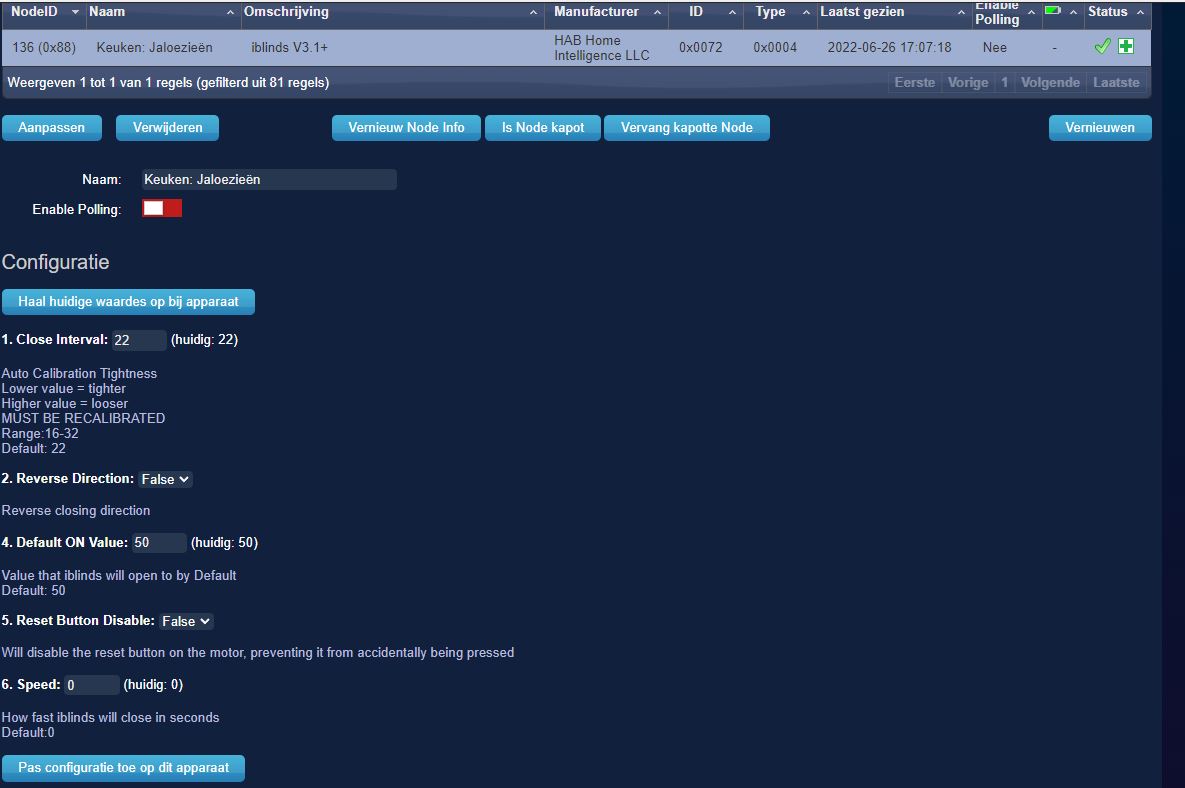

v3.1 is not listed in my openzwave file manufacturer_specific.xml (yet): the device is however by default recognised as a single switch device, which -once it is set to sub type blinds percentage- can be used to operate the blind.
After adding the appropriate line in manufacturer_specific.xml:
  <Manufacturer id="0287" name="HAB Home Intelligence LLC">
    <Product type="0003" id="000D" name="iblinds V2" config="hab/iblindsV2.xml"/>
    <Product type="0004" id="0071" name="iblinds V3" config="hab/iblindsV3.xml"/>
    <Product type="0004" id="0072" name="iblinds V3.1" config="hab/iblindsV3_1.xml"/>
  </Manufacturer>
And uploading the existing hab/iblindsV3.xml file as hab/iblindsV3_1.xml
iblindsV3_1.xml
(3.93 KiB) Downloaded 39 times
the device is properly recognized as iblinds v3.1 by HAB Home Intelligence LLC and some options are shown in the bottom.
Z-wave iblinds v3.1.JPG (87.11 KiB) Viewed 2267 times
One important one, 7- 'Auto Calibration' is however missing.

Conclusion
Physical installation is pretty easy: just follow the 11 steps in the manual. There was not much room to pass the 3 wires for the lifting spools further away from the end by the iblinds motor. In the end I passed the 2nd wire under the iBlinds motor, and those for the 3rd and 4th lifting spool over the iblinds motor. All 3 could not be passed properly without pulling them over/against the iblinds motor, which makes lifting and lowering the blinds a bit harder, but it works. We'll see how long it takes to wear through the wires or the motor house (whichever comes first).
The only thing that I was a bit unsure of was when to do the calibration. I just installed the blinds, and then it turned out the motor starts the calibration process automatically the very first time you issue a level-command to the motor.
I have not physically built it into my blinds yet, so no experience there yet.
Kit v3.1 is not officially supported yet: it is not a know device. Using z-wave's default node information however it can be properly controlled. Options can however not be set without the proper entry in the xml files.
Anyone got the supporting xml file for the iBlinds zwave device already?
In my domoticz it's not recognised yet, so I'll try and build my own file to get it properly recognised, but if someone already got an xml file.....

I found that IB2.0 and IB3.0 do have an entry with manufacturer hab, but mine is 3.1, with a type code of 72 whereas the code in those is 71. So I'll take the 3.0 xml file and point to that. Just need to restart my domoticz, then re-include the device to see if it works now. But I didn't have the time yet. (after a restart of my Domoticz I need to wait for roughly an hour before ozw is fully initialized again...)
I have added my xml file plus the information to add in the manufacturer_specific.xml in the opening post. The only thing missing is the parameter to set auto calibration mode. I have added this now too, but I haven't been able to test it yet.
