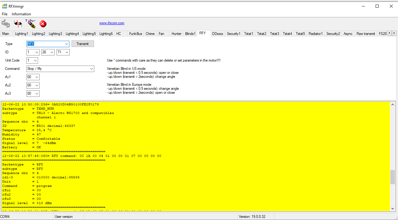

Information from the internet I understand that the RFY protocol is used for this and that you have to learn the new code in the RTS engine.
Teaching the new code via my laptop directly connected to the RFXCom via a USB cable was successful.
I added an extra code with the "Program" command.
Then, in addition to my existing remote control, I can also control the screen with the laptop.

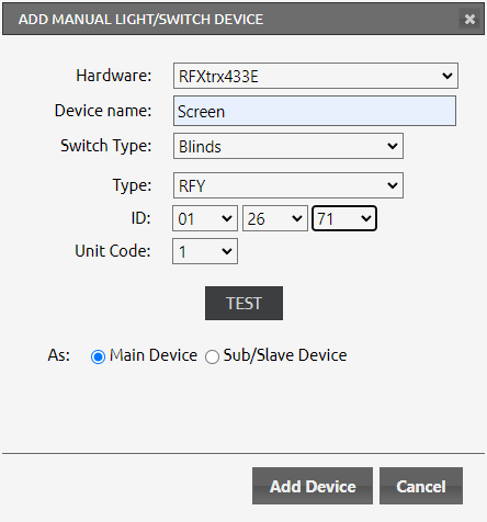

I then reconnected the RFXCom to Domoticz on a Raspberry PI.
There I added a switch with similar settings.
If I then want to operate the screen via Domoticz, I see the following error message in the logging:
subtype = Unknown RFY remote! Use the Program command to create a remote in the RFXtrx433Ext
Can someone point out what I'm doing wrong?

b_weijenberg
Posts: 521
Re: Control Somfy awning with RFXCom
Post by b_weijenberg »
The ID in the RFXmngr program command in the yellow screen is 010000 !

I've already got it working. When creating the switch, the "test" button in Domoticz is important, which apparently also functions as a program button.
By pressing the "prog" button on the Somfy remote control (screen responds) and then pressing the "test" button in Domoticz, the RTLS engine will learn that code.
