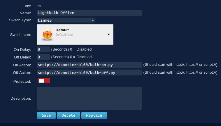

Now I'm trying to change the virtual switch to switch type "dimmer".
Now I see the "on action" script is called anytime I move the slider in the GUI:
2022-06-05 16:55:12.856 Status: User: Admin (IP: x.x.x.x) initiated a switch command (73/Lightbulb Office/Set Level)
2022-06-05 16:55:13.076 Status: Executing script: /opt/domoticz/userdata/scripts/domoticz-kl60/bulb-on.py
Is domoticz somehow passing the level to the "on action" script or I need to use a different way?
In the pyHS100, I can set the brightness of the bulb with this function:
bulb.brightness = <0-100>
