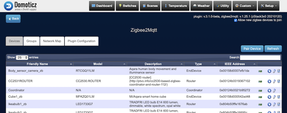

Well, maybe I didn't understand your problem but zigbee2mqtt 3.1.0-beta works fine, I've installed using plugin manager.
Schermata 2022-06-05 alle 21.14.50.png (283.66 KiB) Viewed 1324 times
