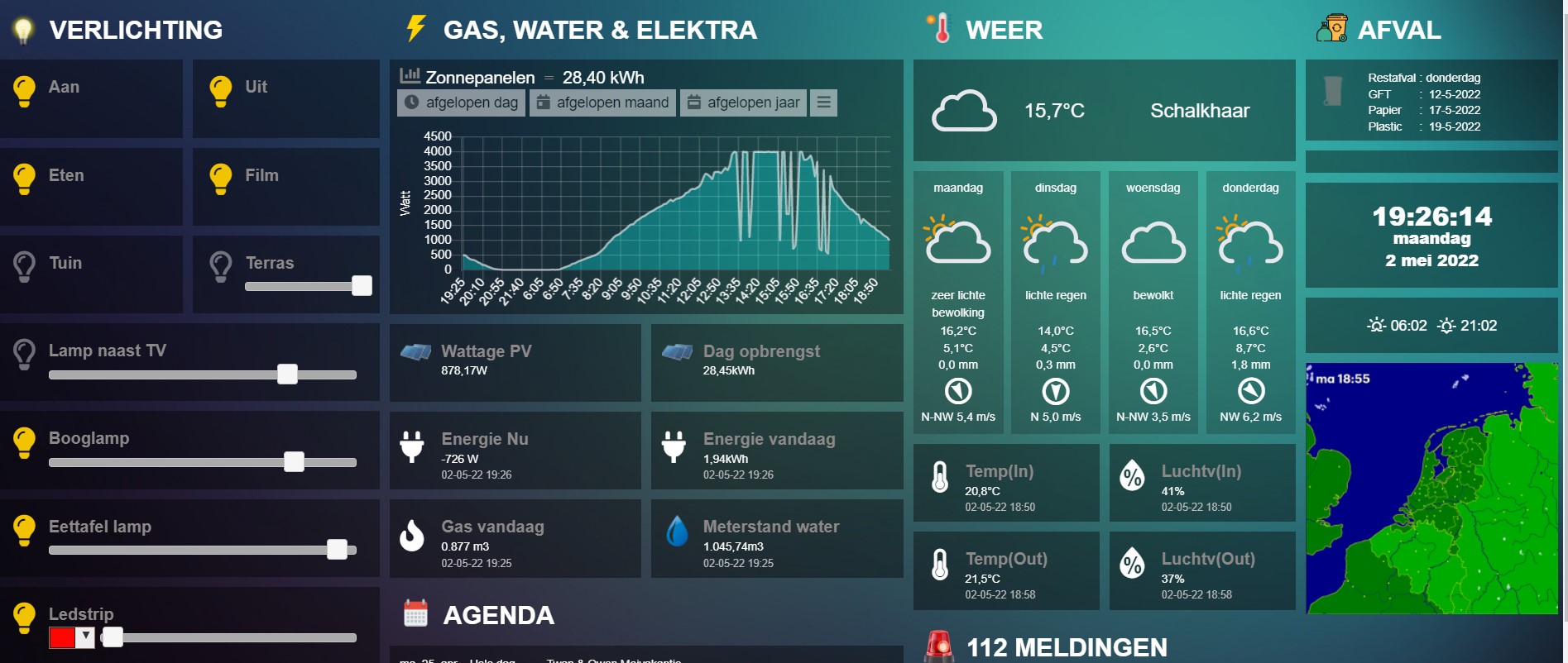

the slowness was the snapshot function of the camera in domoticz.
so the only problem now is the mobile template that it shows om my mobile and tablet.
on my laptop it looks normal

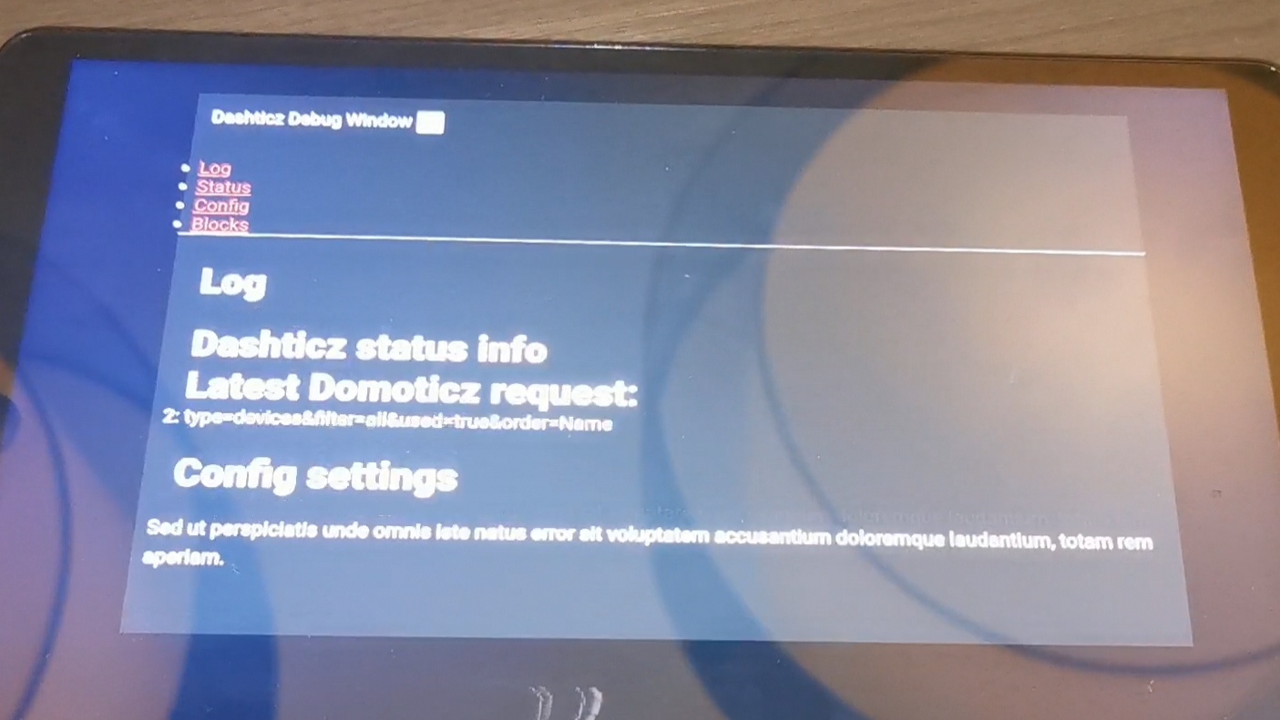

The browser also shows a fast/strange screen before loading dashticz?
- Screenshot_20220502_230004_com.huawei.himovie.overseas_edit_121311055123674.jpg (230.11 KiB) Viewed 961 times
Lokonli
- Posts: 2296
Re: strange resolution after updating to beta
It seems that one of your css files doesn't load correctly.NilsNijenhuis wrote: Monday 02 May 2022 23:04 The browser also shows a fast/strange screen before loading dashticz?
It may be a caching issue. On your tablet try to clear caches, or open in a private browser window.
