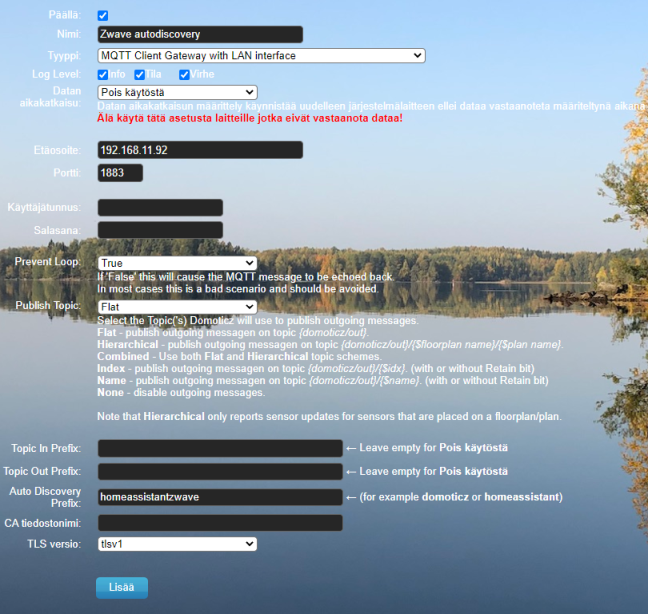

I have a strange problem. Whenever Domoticz restarts (this happens usually once a week or so, I have monit in use so I don't always know right away when it happens), the zwave mqtt autodiscovery stops working. If I try to e.g. press a zwave switch after restart I get message with like something "incorrect ID" in Domoticz GUI. After I go to zwavejs2mqtt settings and press "Save" I can see in the log all the devices discovered and they start working again. So there are no new devices created, just the old ones start working again.
What do I need to do to keep them working through restarts (preferably without the need to recreate any devices)?
These are my settings:
- domo.PNG (367.42 KiB) Viewed 1782 times

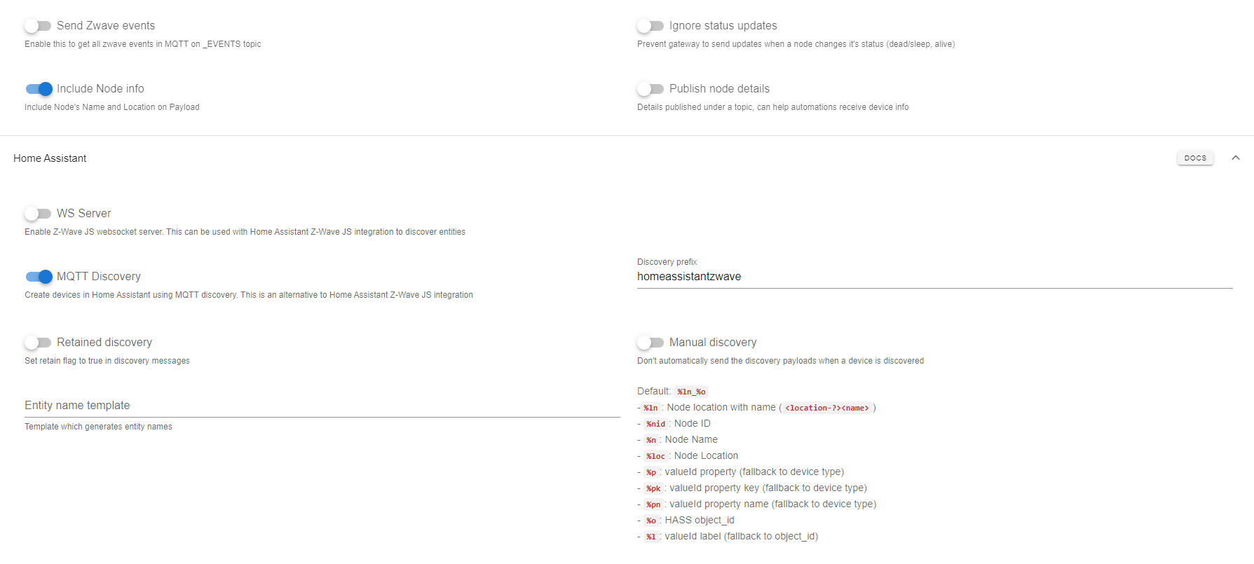

Try to set on "Retained Discovery"
The configuration which woeks for me:

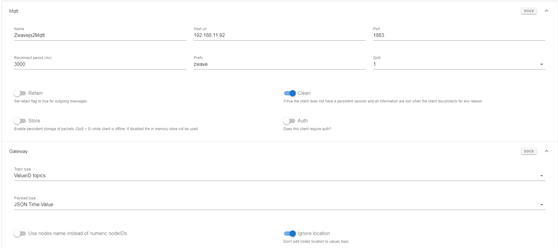

I configured zwavejs2mqtt with the help of these recommendations:
https://github.com/moroen/ZWave-MQTT-pl ... avejs2mqttBut as mentioned couple of posts above:Gateway configuration:
Use node names instead of numeric nodeIDs: Off
Ignore location: On
Include Node Info: On
Note: Specifying node names and locations in zwavejs2mqtt is not required, but recommended. This will generate somewhat sane names of the devices when they are added to domoticz.So my retained flag was on. I took it off and everything started working again. I thought this was it. But then I needed to do one more change and when testing the device in Domoticz after the change, it did not work right away. And I'm not fully sure what I did to make it start working againNow, when I look at the topics in mqtt explorer, I can see only one ID under discovery node, yesterday I saw several of them. I can see them under zwave node though. Why have they disappeared from discovery? Can it be the fact that I enable OZW for a while to get my old device names? Since then I've restarted the system and everything so shouldn't it recover? Can I force the discovery topics to be populated somehow again?
edit. I turned the "retained discovery" switch on in zwavejs2mqtt to "on" and now I have the nodes back under discovery topic. Not sure if this is the right way to do as it was mentioned to best to keep it off...

I had a big struggle with the same symptoms... but I am using DZ MQTT Auto discovery hardware, not the same as you.
in ZwaveJs2MQTT, I have the "clean" option checked (ON), and it works well. Also, the retained discovery is checked (ON).
Maybe there is an attention to have on connexion to your MQTT broker by observing its logs, crossing that with DZ logs. In my case, DZ MQTT AD used to always lose its connection to the broker and restart a discovery that did not work well... now it seems to be solved.

I've made some tests on this. It looks like every MQTT Auto Discovery device change, that restarts the worker and makes it disconnect/reconnect to MQTT generates this problem. For what I've tested, either of below things fix it:
1. Save ZWavejs2MQTT config in GUI, which generates auto discovery broadcast to MQTT
2. Set Retained discovery to ON (against docs suggestions), that makes all auto discovery info available for MQTT Auto Discovery device on reconnect.
It seems, that MQTT Auto Discovery needs to get all discovery info after each restart (or even reconnect). So either it has to be available on MQTT server, or generated again (by zwavejs2mqtt).
BTW - setting Clean -> ON doesn't seem to make any difference.

I have not updated zwavejs2mqtt in quite a while (probably longer than 6 months) since it's very stable for me.
There's 2 retain switches: the mqtt retain (which is "off" in my case) and the homeassistant retained discovery which I have had "On".
Other than that, my settings are the same as yours. I have persistence set to true in mosquitto.conf but I am not sure if that's the default.

So far, so good. Several restarts behind and zwavejs2mqtt keeps connected with Domoticz
I think the other retain flag was the key as suggested by @heggink. Had overlooked this option thus far. Thanks a lot!
