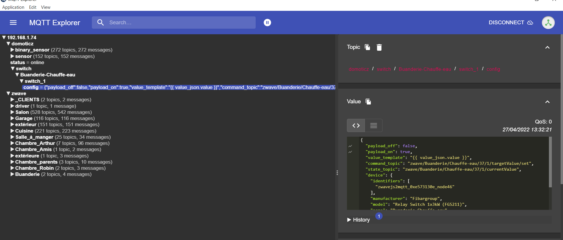

Here is my MQTT explorer at DZ, Mosquitto and ZwaveJsMQTT start
Sans titre.png (88.86 KiB) Viewed 2935 times
with the DZ previous error message still present every 2 minutes :
Error: Zwave: disconnected, restarting (rc=19/Unknown error.)
In Mqtt explorer, seeing the Domoticz Topic, there is NO switch or lights, only sensors...

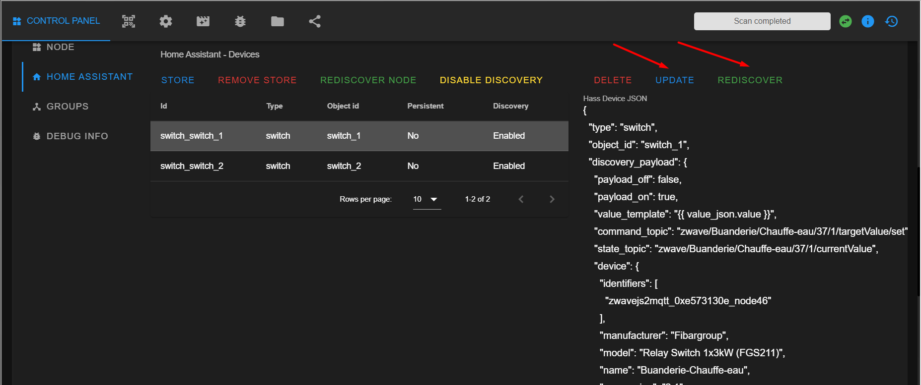

then If I force discovery from ZwavejsMQTT
Sans titre2.png (95.2 KiB) Viewed 2935 times

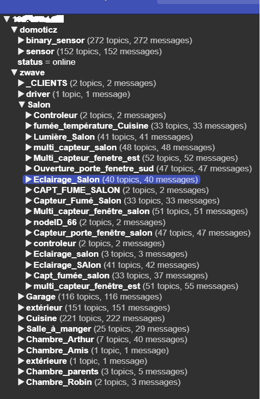

I can then see it in MQTT explorer under Domoticz Topic :
Sans titre3.png (87.47 KiB) Viewed 2935 times
Now this Switch is working from DZ (previously I had an error message while clicking on it) and I don't have anymore the DZ MQTTauto discovery error message... but the other switches are NOT working from DZ (working from ZwajsMQTT), only the one I have reforced the discovery is working...
than, clicking "SAVE" in zwavejs2MQTT config generated a rediscovery in DZ and.. here it is (se next Post :

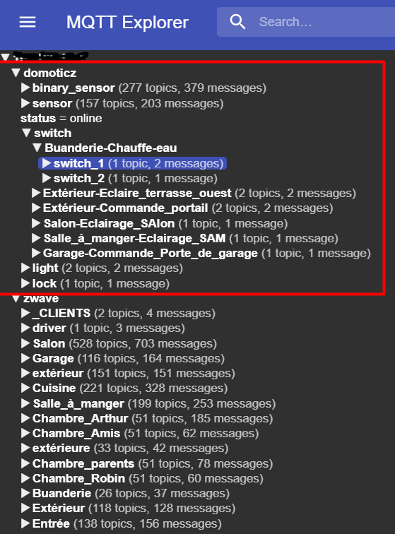

Sans titre4.png (58.38 KiB) Viewed 2934 times
and now ALL is working....

Ah also, previously, i did removed all the wrong topics via MQTT explorer... : re enable topic to use names and delete all topic containing an ID number...
