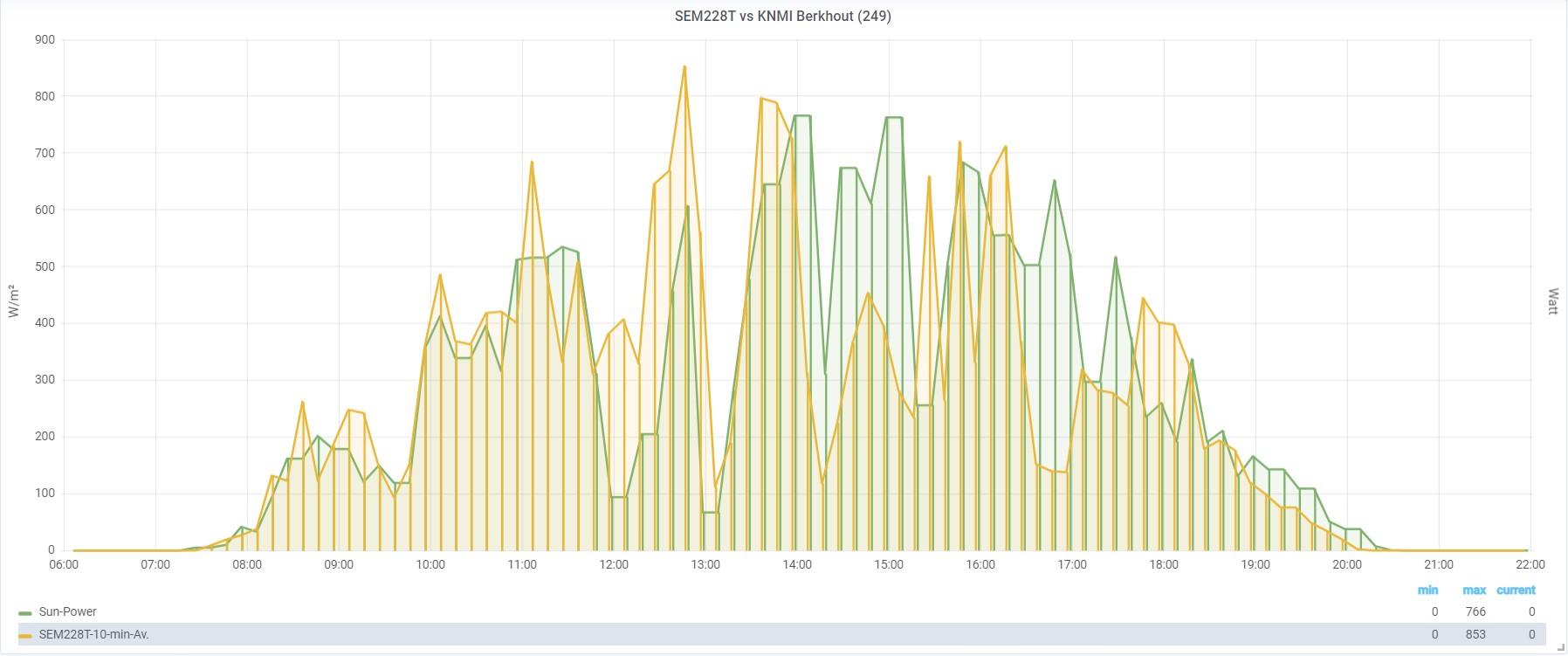

Schermafbeelding 2022-04-03 233820.jpg (176.59 KiB) Viewed 807 times
waltervl wrote: Saturday 02 April 2022 0:23 That is good news.
But I think there is no need to reset the history every 10 minutes as it will take the history of the last 60 samples as that is what is stored in the history data table. So if sample 61 is added, sample 1 is deleted.
After one day of testing I think the script is exactly doing what I want it to do. Now I only need one or rather a few clear sky days to calibrate with a nearby official weatherstation. In the graph that is "solar radiation" of KNMI station Berkhout about 5 km as the crow flies from my house .
