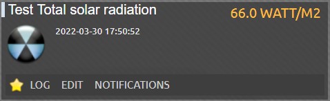

To be quite honest, I don't know exactly.
I assume solar radiation because I had to enter it in the plugin that retrieves the data via Modbus. I have given both of your suggestions a try. No luck so far.
Sensor looks like this and it's in the weather section. No further indication.

         local SunPowerWatts = domoticz.devices('Test Total solar radiation').sValue
	domoticz.devices('Sun Power SEM228T').updateCustomSensor(SunPowerWatts)
	--domoticz.devices('Test Total solar radiation').dump()
That goes with the sValue of 'Test Total solar radiation'. That is a string and not a number. That's why I think it works with temperature (number) and not (yet) with my sensor (string). I just don't know how to turn that string into a value that the Statistical function can use (number).

SOLVED!!!
return
        devices = {'Test Total solar radiation'}
    logging =
        level = domoticz.LOG_DEBUG,
        marker = 'SEM228T',
    data =
        SEM228THistory = { history = true, maxMinutes = 10},
    execute = function(domoticz, sensor)
        -- add new data
        domoticz.data.SEM228THistory.add(sensor.radiation)
        -- average
        local RadAverage = domoticz.data.SEM228THistory.avg()
        domoticz.log('average radiation ' .. RadAverage, domoticz.LOG_INFO)
2022-03-31 14:23:56.303 Status: dzVents: Info: SEM228T: ------ Start external script: SEM228T10M.lua: Device: "Test Total solar radiation (Test Total solar radiation)", Index: 610
2022-03-31 14:23:56.319 Status: dzVents: Info: SEM228T: average radiation 137.90196078431
2022-03-31 14:23:56.323 Status: dzVents: Info: SEM228T: ------ Finished SEM228T10M.lua
