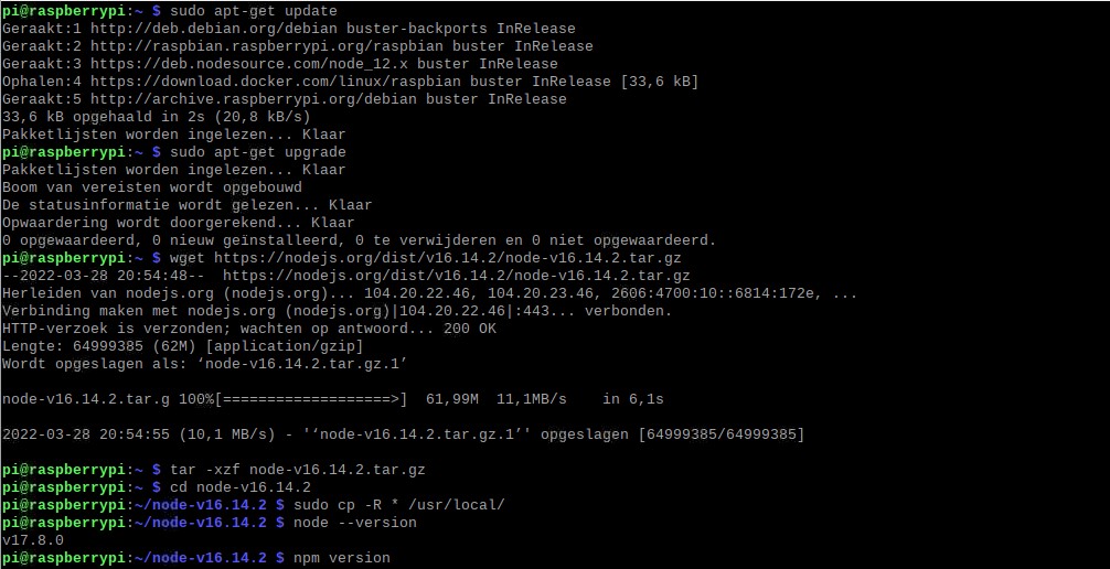

Unfortunately this installation end up with version 17.8.0. Is it possible that version information kept elsewhere in the system and has no affect on the sudo apt purge nodejs command?

Your download has been successful, but unfortunately somewhere in your path an old version 17.8.0 is still installed.
It also looks as there are (at least) 2 versions of v16.14.2 been stored. See: node-v16.14.2.tar.gz.1.
There is still also a file called node-v16.14.2.tar.gz, otherwise it would not have been possible to extract that file.
So you have 2 files of node-v16.14.2.tar.gz and one installed version v17.
One version of v16 you will find in /usr/local
You have to remove v17 first.
How to uninstall it, depends on the way you installed it (apt, nvm or download/extract/copy (as we did just now))

After several options to deinstall Nodejs I finally manage to solve it.
Did a reinstall with version 16.x and now its reproducing the right version of Nodejs and NPM.
Zigbee2mqtt is working and all Zigbee devices are up and running.
