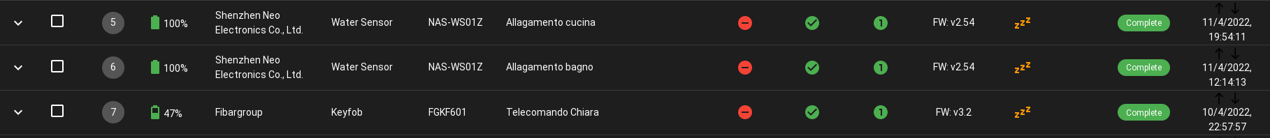

One question (ok I know what "should be supported" means).
my zwave setup includes two Neo Coolcam water sensors and a keyfob Fibaro FGKF601. In the zwavejs2mqtt control panel I can see the battery status of all my (three) battery powered devices:
but in the domoticz devices panel I can see only the Neo Coolcam water sensors battery status.
Is there a way to activate this? I remember that with the old OZW battery was shown.

Here is a fragment (not all due to the forum limit exceed) of the "debug" as in the zwavejs2mqtt control panel:
