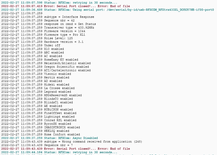

Hello Experts,
since two Days i get an error - every 30sec USB connects und disconnect my RFXCom XL from USB....
2022-02-27 10:02:25.902 subtype = Interface Response
2022-02-27 10:02:25.902 Sequence nbr = 18
2022-02-27 10:02:25.902 response on cmnd = Get Status
2022-02-27 10:02:25.902 Transceiver type = 433.92MHz
2022-02-27 10:02:25.902 Firmware version = 1044
2022-02-27 10:02:25.902 Firmware type = Pro XL1
2022-02-27 10:02:25.902 Noise Level: 126
2022-02-27 10:02:25.902 Hardware version = 3.1
.... her are some lines with the protocols
2022-02-27 10:02:25.250 Status: RFXCom: Using serial port: /dev/ttyUSB2
2022-02-27 10:02:25.902 Status: RFXCom: Async Disabled
2022-02-27 10:02:31.409 subtype = Wrong command received from application (40)
2022-02-27 10:02:31.409 Sequence nbr = 7
2022-02-27 10:02:31.826 Status: RFXCom: retrying in 30 seconds...
2022-02-27 10:02:31.409 Error: Serial Port closed!... Error: End of file
Raspberry Pi4 Buster
RFXCom connected directly to USB / No Hub
Version 2022.1
Whats wrong - i can't find an issue!?!?
Btw: Same Problem with
Using serial port: /dev/serial/by-id/usb-RFXCOM_RFXtrx433XL_DO5O57NE-if00-port0
2022-02-27 10:22:49.439 Status: RFXCom: Async Disabled
2022-02-27 10:22:56.364 Status: RFXCom: retrying in 30 seconds...
Thx for your help!!!

Re: RFXCom - Error Connecting to USB: Error: Serial Port closed!... Error: End of file
Power supply is loosing power?

Thx waltervl,
Yes - i use a new 4A USB-C Supply since yesterday, before it was a 3A USB-C.
waltervl wrote: Sunday 27 February 2022 11:46 Power supply is loosing power?
And since then you have this issue?

No... the issue was before. I also thing, there is a Power-Problem...
waltervl wrote: Sunday 27 February 2022 12:12 And since then you have this issue?

Maybe to many protocols enabled?? I thought the manual advise is only the ones needed..
And maybe to many other devices connected to your RPI?

Enabled protocols is no reason for this problem.
In most cases it is a bad power delivered by the RPI to the USB.
Try another USB cable, use a powered USB hub or use the RFXtrxLAN.
The RFXtrxLAN (LAN or Wifi version) has his own power supply and can be located on the best location for 433 receive and transmit.

Hi...
i will wait for the RFXtrxLAN....
Thx for your help
Tom
b_weijenberg wrote: Monday 28 February 2022 10:48 ...... or use the RFXtrxLAN.
