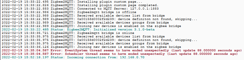

Decided to move to a CC2652 as I seem to be having issues with my old setup of Conbee II - Phoscon - deConz where devices will randomly stop working or just disappear from Phoscon but still be functional in Domoticz.
Rather than trashing the whole thing and starting again I decided that as I have a spare pi 3B+ I would do a fresh buster install, perform all updates, install zigbee2mqtt and mosquitto, configured all relevant files, .yaml is set for ttyUSB0 for the coordinator etc etc. All install went without an issue, finally installed domoticz, added the python plugins manager and then Zigbee2MQTT under hardware, nothing else is installed and yet when i go to the customs tab and open Zigbee2MQTT it just sits there loading, doesn't show my coordinator or give me the option to add devices, as this is a brand new install I can't see what could be causing a problem but i do get his in the log.
2022-02-19 15_57_14-Domoticz — Mozilla Firefox.png (22.79 KiB) Viewed 437 times
Anybody have any ideas?
TIA
