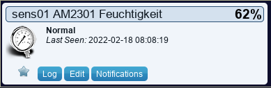

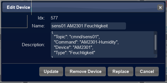

I have a NodeMCU running Tasmota 11 with a AM2301 (DHT22) connected to it. The devices are correctly picked up by the Tasmota Autodiscovery plugin.
Values are shown correctly, but Domoticz does not keep a history for the humidity readings. Do I need to change a setting?

Standard Humidity device keeps track of Humidity but it looks like the plugin uses something else.
A humidity sensor also needs an indication of the status (normal, wet, dry etc) so it needs 2 parameters. This status then needs to be calculated by the plugin.
So discuss this with the plugin owner.
