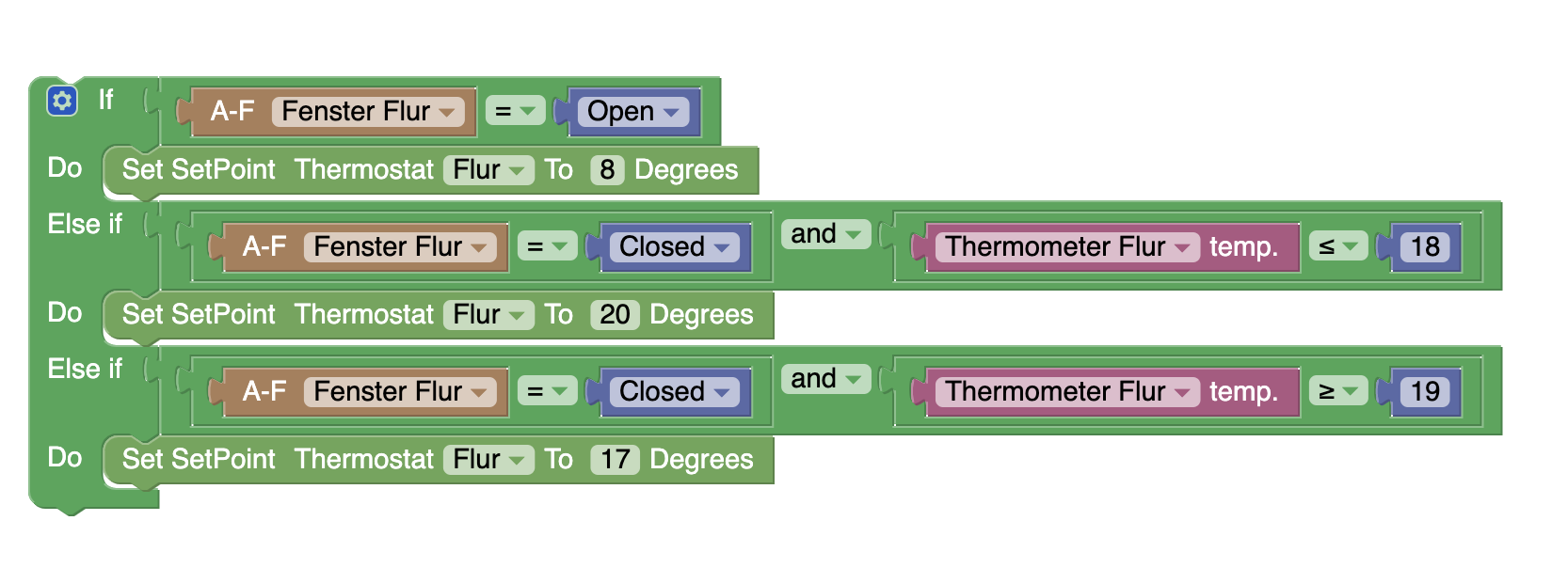

Only window:

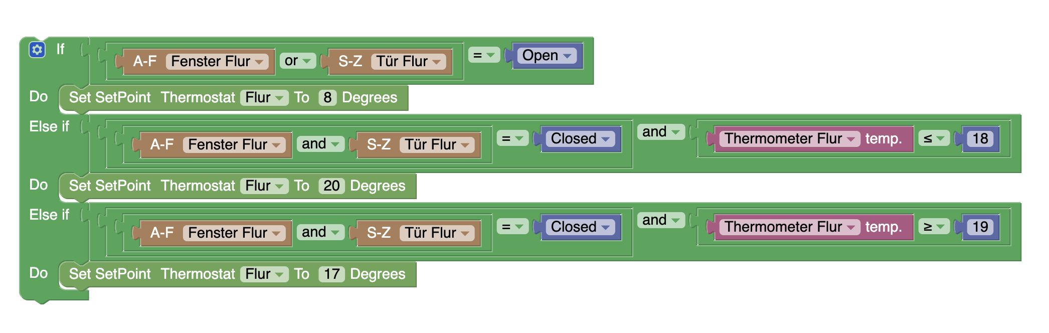

Window and door:

You need to test for each device to be "Open" not like you have done the or/and now, so
if fenster flur = Open or tür flur = Open
do ....

I changed the first part and that's working now. But as soon as I close either window or door, the thermostat is not set back to 17 or 20 degrees.
Bildschirmfoto 2022-02-16 um 14.24.53.png (189.85 KiB) Viewed 2026 times
Do I have to change the conditions in the second and third part as well?

Are you testing the correct SETPOINT TEMP value there or are you testing against the actual temp with that device?
BennY
Posts: 24
Joined: Tuesday 27 February 2018 8:25
Re: Blockly with two sensors not working as expected
Post by BennY »
is it possible, that your current temperature "Thermometer Flur" was between 18°C an 19°C when you Test your blockly?
If your Thermometer Flur is higher 18°C and lower 19°C your Thermostat will not Update the Setpoint.
For testing you could try <=18 and >18.
Benny

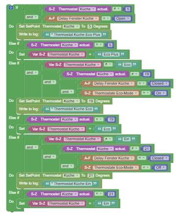

I have some Danfoss LC-13 and use this blockly to contol them. The internal controller works very well, for me there is no need to controll them with an external temperature sensor. Sometimes they want update the Setpoint, so I set the Setpoint every time they Wake-Up (15min in my case) and don't have the right Setpoint.
Thermostat Control

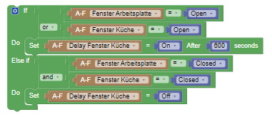

That's the Delay Option for my Windows.
Window Delay

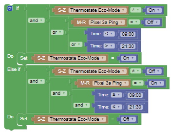

And the Eco-Mode (Nachtabsenkung, don't know the english term)
