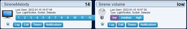

Level names of selector switch are reset.
Post by EddyG »
See: viewtopic.php?f=59&t=37823
It works to rename the level names from the defaults to my preferences.
BUT. after a message from zigbee2mqtt of this device all levelnames and levelactions are reset to the defaults.
Even the manual set selector style is reset to the default of 'button set' which does not show good with 18 levels.
What can de done about that?

My solution so far.
                devices = { 'Sirene Melody', '$Sirene melody' }
        execute = function(dz, item)
                local level = item.level
                if (item.name) == 'Sirene Melody' then
                        dz.devices('$Sirene melody').switchSelector(level).silent()
                        dz.devices('Sirene Melody').switchSelector(level).silent()

Edit: I did the same for the climate selector device, and my change in Low, Medium, High (instead of low,medium,high) stays that way.
I also found out that with the melody selector switch 18 selector levels (ranging from 0 to 170), that there is a problem with level 0.
It is not selectable!

So in the first example the selector contains 3 options. I would assume that if I send the second example (which contains 4 levels), the switch should be updated to support the new levels.
In MQTTAutoDiscover.cpp at line 2259 and 2260 I see that there's a check to see if we have new options, but I can't get this to work.
	if (newOptions != sOldOptions)
		m_sql.SetDeviceOptions(DevRowIdx, optionsMap);
Was anybody able to add extra options to a selector switch? If so, how did you proceed?
