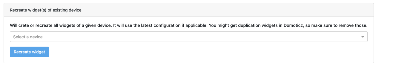

I think I have corrected. You can simply retreive the latest beta, then you can use a new feature in the WebUi to recreate the widget, and then AFTER you can remove the old one.
This can be done in Admin > Provisionning
Screenshot 2022-01-14 at 23.45.15.png (29.2 KiB) Viewed 1353 times
