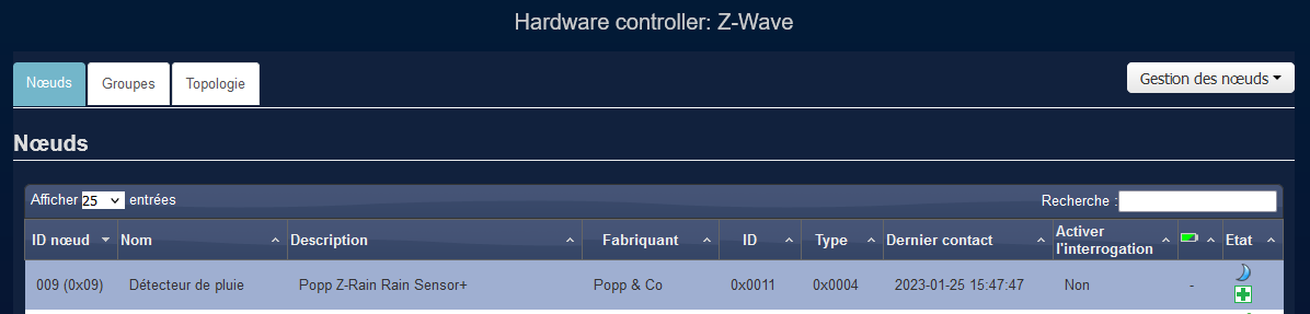

Romain2022
Posts: 13
Joined: Friday 16 September 2022 14:31
Re: Zwavejs2mqtt auto-discovery of rain meter
Post by Romain2022 »
The wake-up interval is set to 240 seconds for me.
Where do you see the battery status ?
In the hardware controller screen, the column "battery" is empty :
Capture d’écran 2023-01-25 160241.png (28.21 KiB) Viewed 2830 times

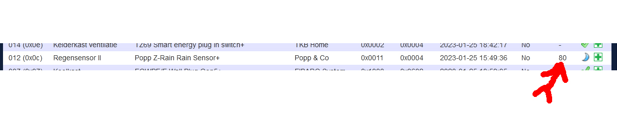

JackD
Posts: 68
Joined: Monday 02 November 2020 20:53
Post by JackD »
You set the wake-up interval very tight, this will drain your battery very fast, but you won't know because you don't see the battery status :oops:
But clearly it is not a to wide wake-up interval setting. I set mine at 14400seconds(4 hours).
Works fine here with beta14957, but it is possible that with the newest beta Domoticz Open Zwave is finally "broken".
Open zwave is depreciated so it is a distinct possibility, go back to my version beta14957 and you will know if this is the case.
beta14957 works fine here, see my screenshot, my battery is at 80%
If open zwave is "broken" than you can try Zwavejs2mqtt or use a older Domoticz version.
