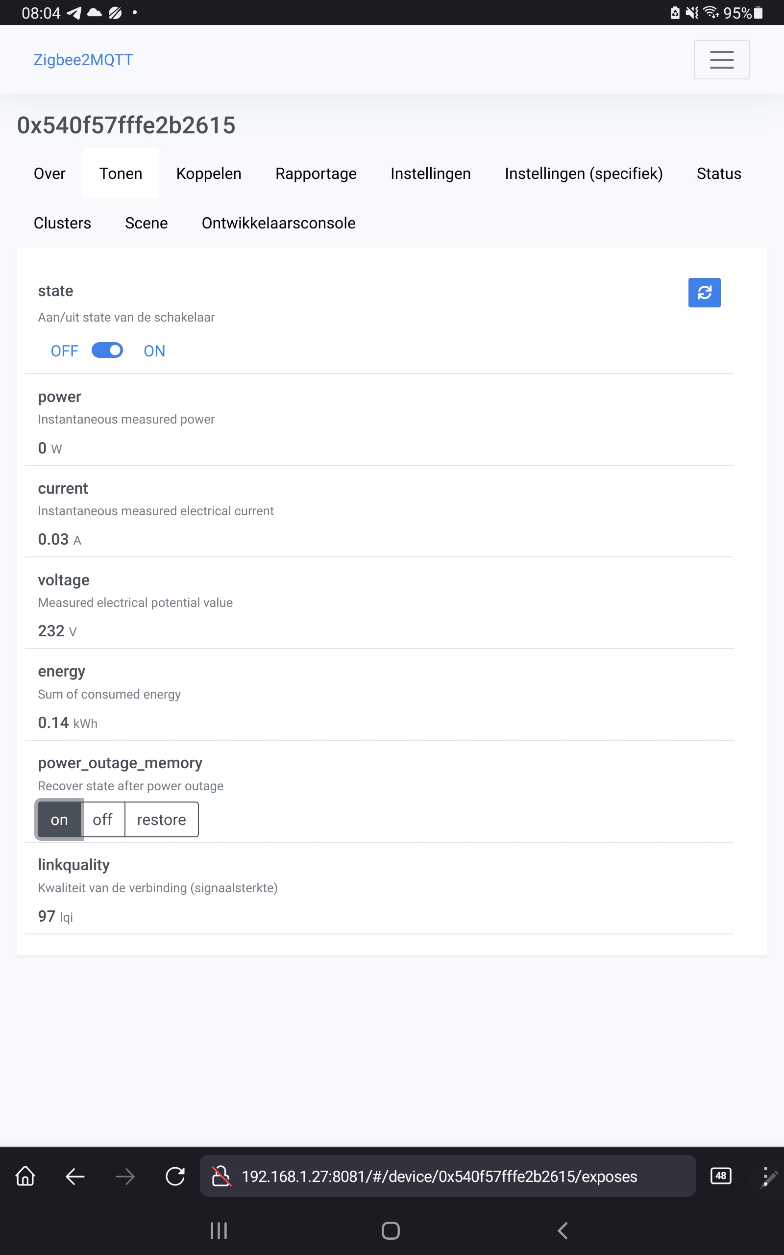

Bought zigbee plug. Zigbee2mqtt identified it as TuYa TS011F_plug_3. Domoticz does not add the powermeasurement devices. Zigbee2mqtt says updating by polling. How do I add these zigbee2mqtt devices manual so I can set them to update by polling. Thanks!

Well I did find out myself. Update zigbee2mqtt to latest version. Update domoticz plugin zigbee2mqtt. Empty browser cache otherwise warning and no devices. Set plug in gui zigbee2mqtt on polling. Calculate kwh with in domoticz, that's all. :D
