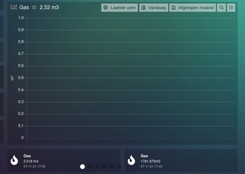

I noticed that since a few weeks my gas usage graph is no longer showing the usage. An example of what I see nowadays:
I examined the block and made some adjustments to the height of the block but had no luck. My block looks like this:
blocks[grafiek_gas] = {}
blocks[grafiek_gas]['title'] = 'Gas';
blocks[grafiek_gas]['devices'] = [200];
blocks[grafiek_gas]['width'] = 12;
blocks[grafiek_gas]['height'] = '400px';
blocks[grafiek_gas]['interval'] = 2;
blocks[grafiek_gas]['graphTypes'] = ['v', 'c'];
blocks[grafiek_gas]['zoom'] = 'xy';
blocks[grafiek_gas]['toolTipStyle'] = true;
blocks[grafiek_gas]['debugButton'] = true;
blocks[grafiek_gas]['datasetColors'] = ['yellow', 'red'];
blocks[grafiek_gas]['legend'] = {'v_200': 'Verbruik', 'c_200': 'Totaal'};
blocks[grafiek_gas]['custom'] = {
        "Laatste uren": {range: 'day',filter: '4 hours',data: {Verbruik: 'd.v_200', Totaal: 'd.c_200'}},
        "Vandaag": {range: 'day',filter: '24 hours',data: {Verbruik: 'd.v_200', Totaal: 'd.c_200'}},
        "Afgelopen maand": {ylabels: ['M³', 'Ʃ M³'],range: 'year',filter: '1 months',data: {Verbruik: 'd.v_200', Totaal: 'd.c_200'}}
Note that I define the graph at the beginning of my config.js
Any thoughts on how to get my graph working again?
EDIT: The graph in Domoticz itself works. So it has to be a setting in Dashticz (I hope :-) )

It's caused by the following line:
You have defined a legend consisting of v_200 and c_200, but since you are using custom data these data fields don't exist anymore.
If you want to show the legend you could use the following instead:
blocks[grafiek_gas]['legend'] = true;

Hi Lokonli,
That did it! Graph is working again. Thanks!
