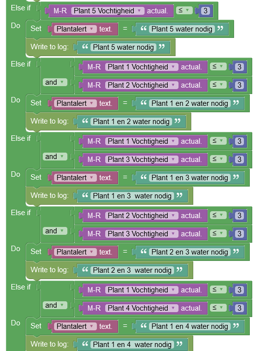

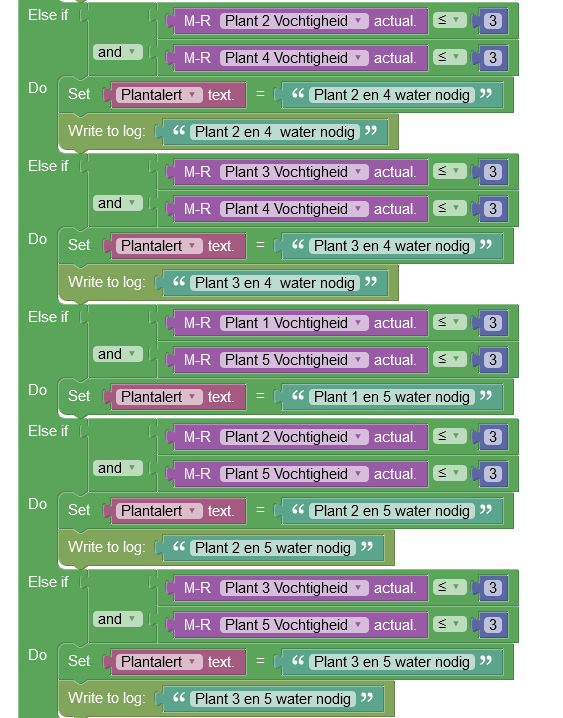

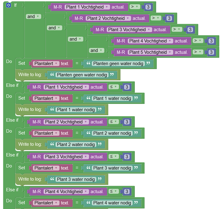

I've got a blockly active that actually works fine.
Yet, to accommodate for all events it is getting too large.It's a blockly that triggers once every day (at 12 o'clock) to pick up the values of 5 plantwatering sensors and triggers an alert-output when the value of any of these sensors comes blow the value of 3% soilmoisture.
To be able to accommodate for all of these different variables of the 5 sensors the blockly is getting way to large for comfort.
The question:
Is there a way to put this in more easy blockly or( if need be) another kind of script, dzvents or such that keeps reading all the sensors and triggers when one of more of the 5 sensors exceeds the value. And does so to account for all the different outcomes possible in the right way to show them in the alert ? Because as times passes I keep adding variables that I did not account for. Appearantly there are A LOT of combinations the way I constructed it now.
There MUST be an easier way, but I don't see it.
Perhaps something along the way of: if one or more sensors exceeds the 3% treshold put those sensors in the alert ?
Here is the blockly in the first 3 files.. the remaining 3 parts in the next message. Yup, it IS large ;-) and cant attach more the 3 files per msg.
See spoiler: (so I won't flood the forum with many large png's)
Any help and/or insights would be greatly appreciated.

No one has any suggestions ? :roll:
How do I account for all of the five different sensorvariables, and not get an awfully large Blockly script
But at the same time get the right plantwateringtext in the text button.
So for instance: plant 1, 3 and 5 need water
"Life is too short for bad coffee"

You might split it up into 5 blockies, 1 for every plant, or put everything in a dzVents script.

It would be a lot easier if you move to a code script : while your checking your plant, you can generate your log message.
Message = ""
If plant1< 3 then Message = Message + "1"
If plant2< 3 then Message = Message + "2"
If plant3< 3 then Message = Message + "3"
If plant4< 3 then Message = Message + "4"
If plant5< 3 then Message = Message + "5"
If Message == "" then Log = "No need for plants"
Else Log = "Plants " + Message + " needs water"
Moderator on Easydomoticz.com, the French DomoticZ forum.

Yes, it would be easier in dzVents. I am not sure of the way to access the device value, but it could look like:
local plantDevices = {
-- use ['name'] = 'deviceName', pairs. Currently numbers, but could be ['Cactus 1'] = 'Plant 17 Vochtigheid',
	['1'] = 'Plant 1 Vochtigheid',
	['2'] = 'Plant 2 Vochtigheid',
	['3'] = 'Plant 3 Vochtigheid',
	['4'] = 'Plant 4 Vochtigheid',
	['5'] = 'Plant 5 Vochtigheid',
-- this depends on the device type
local needWater = function(domoticz, deviceName)
	local device = domoticz.devices(deviceName)
	return device.moisture <= 3
        timer = {
        	'at 11:57' -- avoid full hour when other processes might happen
    	local need = {}
    	for name,deviceName in pairs(plantDevices) do
    		if needWater(domoticz, deviceName) then
    			table.insert(need, name)
    	local plantText = '' -- default message when no need to water
    	local count = #need
    	if count > 0 then
    		plantText = 'Plant'
    		for index,name in ipairs(need) do
    			if index == 1 then
    				plantText = plantText + ' '
    			elseif index == count then
    				plantText = plantText + ' en '
    				plantText = plantText + ', '
    			plantText = plantText + name
    		plantText = plantText + ' water nodig'
	        domoticz.log(plantText, domoticz.LOG_INFO)
    	local textDevice = domoticz.devices('Plantalert')
    	textDevice.updateText(plantText)
Not really tested, and the function needWater might need change (I based it from https://www.domoticz.com/wiki/DzVents:_ ... l_moisture)

Ok thanks for the effort, guys. With this I can work with
