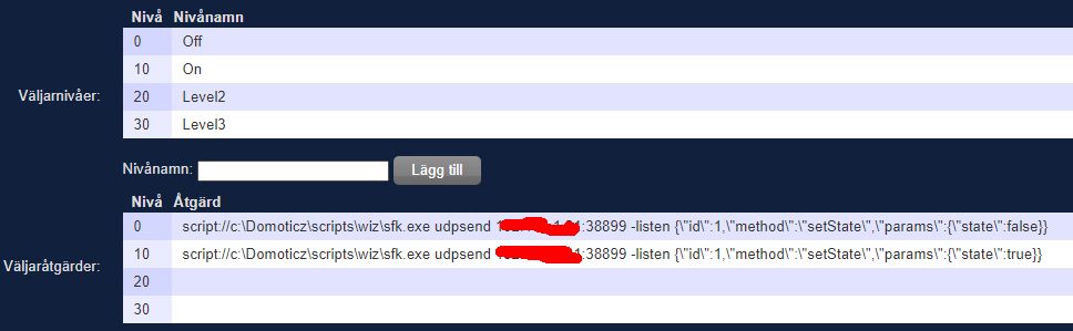

- In the virtual light you created, have a level for every action you would like, for exemple ”Off” and ”On”.
- Connect the level to a script action, see the screenshot below
- Now you can control your WiZ lights!

I noticed for sending from a Windows cmd you need to escape the ” sign. As an exemple, the command for a light is like this (replace the IP address xx.xx.xx.xx with your fixed IP-address of your light):
Turn ON
sfk udpsend xx.xx.xx.xx:38899 -listen {\"id\":1,\"method\":\"setState\",\"params\":{\"state\":true}}
Turn OFF
sfk udpsend xx.xx.xx.xx:38899 -listen {\"id\":1,\"method\":\"setState\",\"params\":{\"state\":false}}
