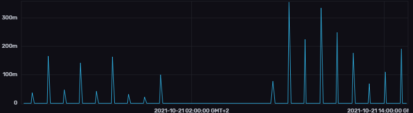

I also think it is possible, but the heating does not use gas fluently in this time of the year every 5 minutes like electricity does.
So you will get a graph that will jump up and down to zero frequently. I don't think that will look nice.
I think that is why the developers decided to use columns.
But you can also use influxdb and grafana to make your own graphs, I did that.
I can tell you is does not look nice when the heating season starts.

It so happens that I still upload Gas data to my influxdb (on a Synology NAS in a Docker container) so I grasped a picture of the last 24 hours of my upload to influxdb. It is not so nice imho.
