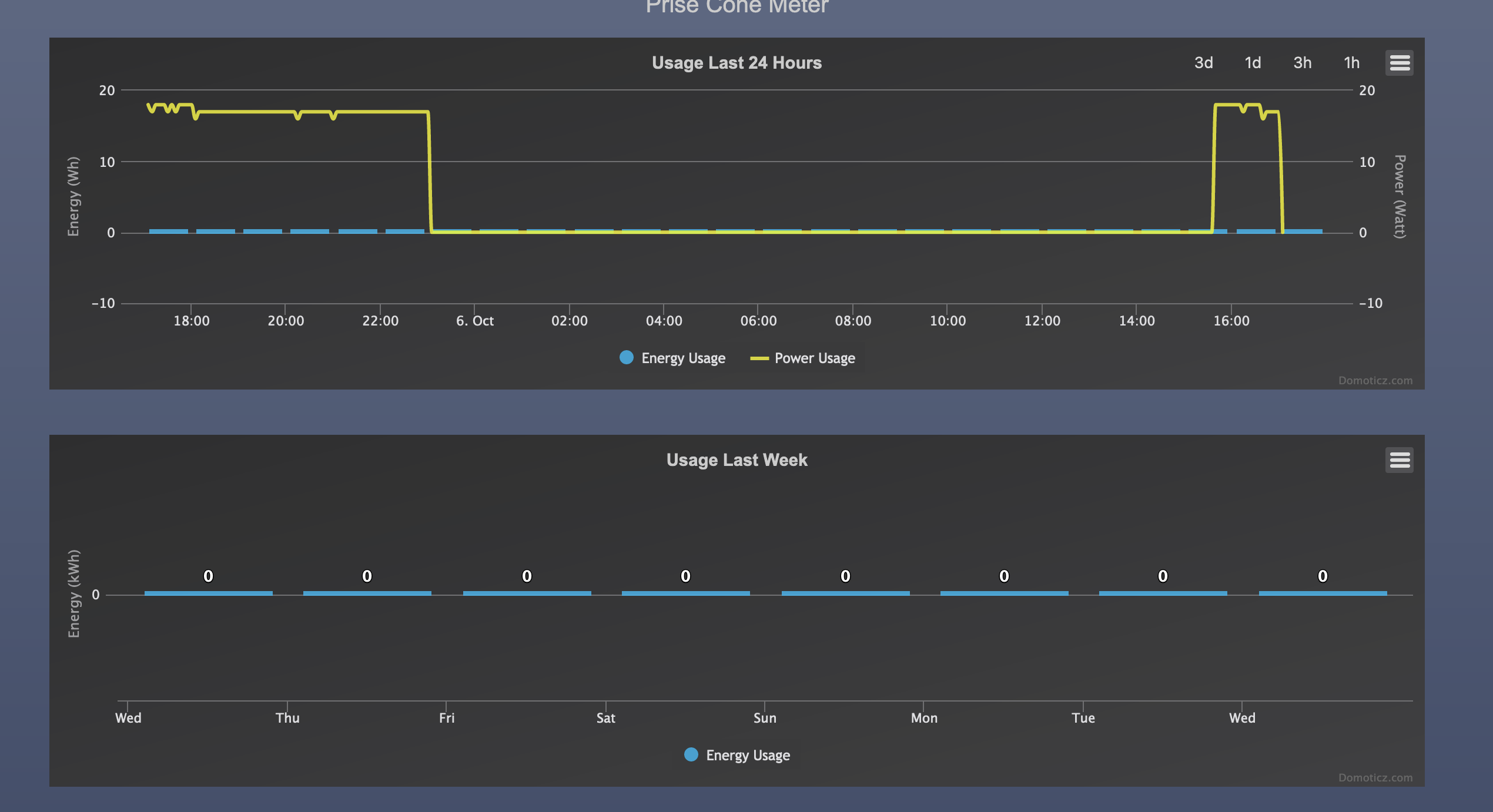

My main issue is that the Usage remains to 0
Here after are the log. We see the Instant Power, but nothing happen for the Usage !

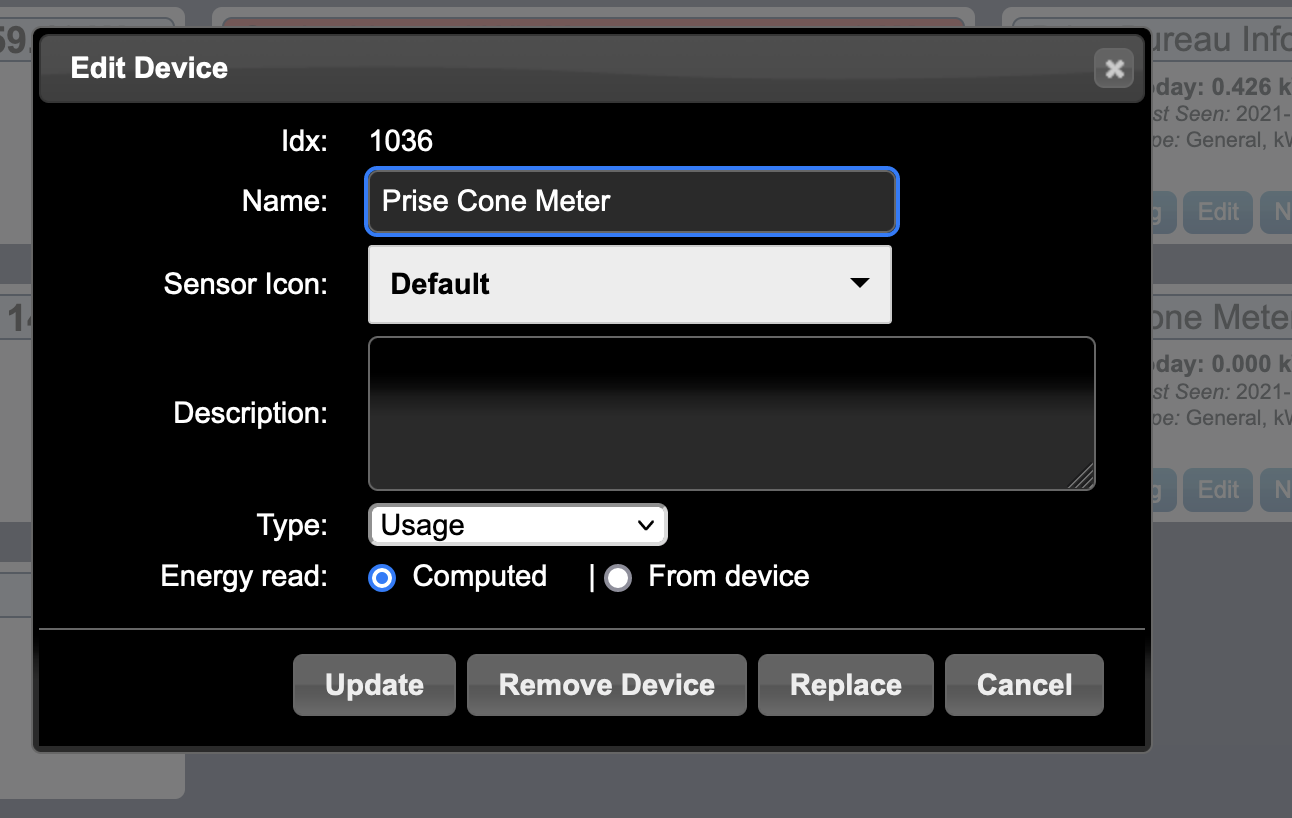

I've checked the device and it is defined as COMPUTE as you can see in the hereafter screenshoot
