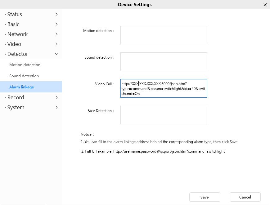

Program the URL links. For this you have to install foscam VMS, to get to those settings. This is freeware software from foscam
Keep in mind, you need to have the lastest firmware for this, older version have a bug. I use this version: VD1 Firmware 1.x.2.23 [02-09-2021]
Just take the domoticz JSON commands and it works. I used a dummy switch in domoticz, it perfectly switches On

The doorbell has more url options.
Foscam products have a range of cgi commands which can be send by url. Like motion alarm On or Off.
There are a lot more command. Foscam even made a pdf file for it. Not all commands work out of this pdf, but there is a logic how the url needs to be build, you could read out the settings and reproduce the correct cgi url

since I use a username and pasword for my domestics set up I'm unable to get the camera working in my dummy switch
testing in webbrowser does work and disabling the pw protection of Domoticz also works.
Anny tips?
http://IP:port/json.htm?type=command&param=switchlight&idx=4823&switchcmd=On
http://PW:USN@IP:port/json.htm?type=command&param=switchlight&idx=4823&switchcmd=On
http://192.168.7.216:port/json.htm?username:USERNAME&password:PW?type=command&param=switchlight&idx=4823&switchcmd=On
foscam vd1 fw 1.17.2.9

In the meantime native support in Synology Surveillance Station is supported. You can now choose the VD1.
After I have installed Domoticz 2023.1 (build 1563) my json call to Domoticz doesn't work anymore?
A switch in domoticz switches "ON" when someone pushes the doorbell.
With this switch I then send an e-mail with a picture of the person at the doorbell, worked flawless....
It was working, in detector, alarmkoppeling, video-oproep, with:
https://domoticz-ip<:port>/json.htm?username=<base64 encoded username>&password=<base64 encoded password>&type=command&param=switchlight&idx=739&switchcmd=On
I read in release notes that from 2022.2 build 14708 this isn't working anymore!
So I changed it to:
https://<username>:<password>@domoticz-ip<:port>/json.htm?type=command&param=switchlight&idx=739&switchcmd=On
But this don't work!!
I changed also json calls from IFTTT and this works fine in the new format, but not from the VD1 doorbell.
The command works in my browser from the laptop connected to the same WIFI as the doorbell?
Anyone any ideas????

It looks it doesn't have anything to do with version 2023.1
Because efarmer1 reports the same on 19 june 2022, with version 2022.1
If i have it correct. The VD1 doens't do a POST with these URL's, but it does a GET.
Don't know why it does a GET, because what does it want to do with the information it received.
Maybe this gives the problem, when user/pass is added.
My domoticz version is still 2022.1 and then everything works.
I have a test environment on 2023.1, because of the change in user/passwords i didn't update my main environment. First want to test everything.
Will try to test en see what happens, but need to find some time to do this test.

For now i have the same problem with the user/passwords in it.
Made a quick work-around in node-red.
On the end of this message, the flow i made.
Instructions for this flow:
The ip-address + port needs to be filled in with your nodered ip-address + port
What to change in flow:
- Change node "Set motion idx" to the correct domoticz idx number.
- Change node "Set sound idx" to the correct domoticz idx number.
- Change node "Set call idx" to the correct domoticz idx number.
- Change node "Set face idx" to the correct domoticz idx number.
- Change node "Set topic" to the correct domoticz topic in name.
- Change mqtt node to correct mqtt server address.
Possible URL's which can be used
URL for motion detection = http://ip-address:port/foscam?action=motion
URL for sound detection = http://ip-address:port/foscam?action=sound
URL for video call = http://ip-address:port/foscam?action=call
URL for face detection = http://ip-address:port/foscam?action=face
