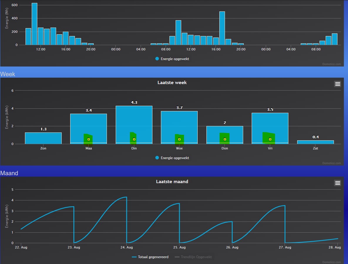

I am busy reading the data from my solis inverter and saving it in Domoticz. I use a script in dzventz for this. I'm so far that I can read that correctly, only processing in a managed counter does not give the desired result. Even after several searches on the internet I have not come up with a solution.
In the script I write the found value to the managed counter with the following commands:
SolarPanel.updateCounter(D.curPower)
SolarPanel.updateHistory(historyTime.rawDateTime,'10;' .. D.curPower)
SolarPanel.updateHistory(domoticz.time.rawDate,'10;' .. (D.energyToday*1000))
This works fine all day long, I see all the values in the right places. only when moving to the next day does it go wrong. Inexplicably, a value of 0 is added in the history, which makes the chart look strange. (see the screenshots)
Schermafbeelding grafiek.jpg (120.83 KiB) Viewed 871 times

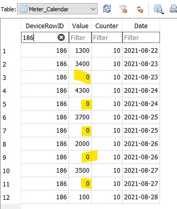

in the database it looks like this
Schermafbeelding database.jpg (46.88 KiB) Viewed 871 times
The question now is does anyone have an idea why this is happening and/or can someone explain how the managed counter works. I have already checked the div wikis of domoticz for this and I can't get any further with this.

The managed counter also shows what I want, only there is the problem that a 0 value is set in the database when the day changes. In another application where I use a managed counter this does not happen. At "find the 7 differences" between these applications I can't find anything that explains the 0 value.

The history on the managed counter is managed by you so you are sending that 0 value. Perhaps make a check or do some extra loggings?
For now, you know you can delete those 0 entries by hand by clicking on the 0 value in the month graph while having the SHIFT key pressed. A popup will be shown to accept the removal https://www.domoticz.com/wiki/Managing_ ... m_database
But I am not sure you can get those 0 values as they are on the same date as the good values.

The problem is not getting the data. That works well. The strange behavior of the manage counter is the problem.
I created a second counter where I don't use the following line
and there I don't get the strange 0 value ???????
maybe a timing problem?
