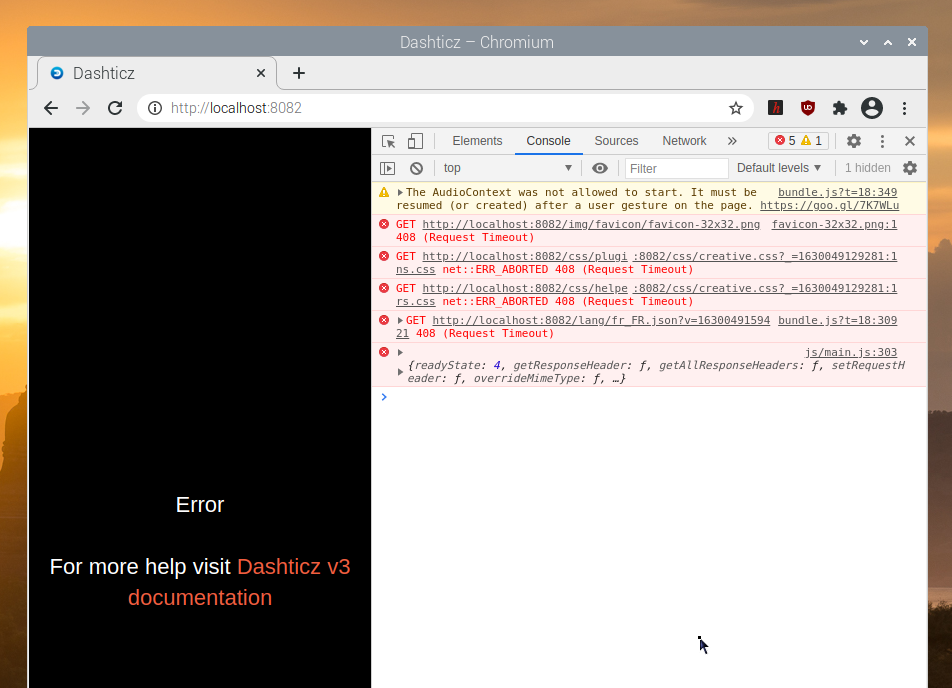

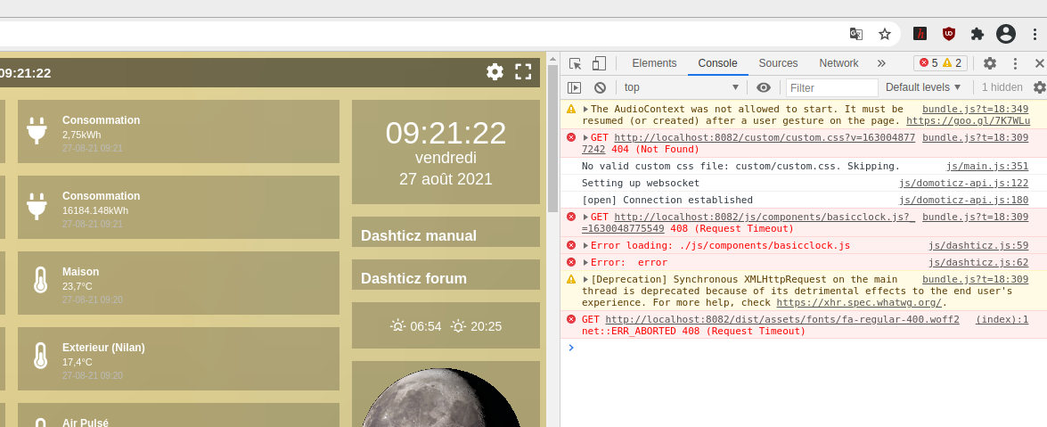

I am jumping into the dashticz world. I have domoticz running (since 7 years!) on Rasperry Pi and has installed (automatic install) Dashticz onto an other Raspberry with a screen attached (both are on the same lan).
Install is ok but when I try to connect on Dashticz, 9 times over 10 it failed with timeout or 404 errors. Even when it succeeds, there are some errors in the console.
Any hint?
When it "works":
2021-08-27 09_21_20-magicmirrorpi - TightVNC Viewer.png (122.81 KiB) Viewed 910 times
When it fails:
2021-08-27 09_24_52-magicmirrorpi - TightVNC Viewer.png (66.97 KiB) Viewed 910 times
or:
2021-08-27 09_26_02-magicmirrorpi - TightVNC Viewer.png (132.18 KiB) Viewed 910 times

no hint no one?
I am searching and searching but cannot find any beginning of idea on how to solve this
