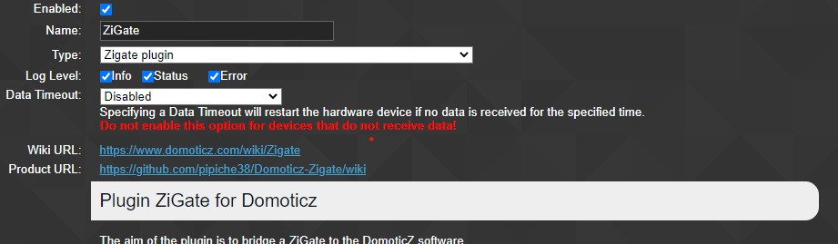

Did you enable the flag Initialise Zigate from the hardware menu ?

Hi Pipiche: I did enable the flag, see the attachment - that is what you mean?

Hi Pipiche, yes, did that too, did it again and no difference.
I switched "Initialize ZiGate" to true, then Update. In the log I see the same as in my original post: the plugin loads with success, but after a minute the errors start. I do have the 2 devices, "Zigate Status 43" and "Zigate Notification 43".

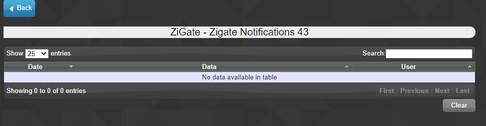

What do you have if you look, after the logs of "Zigate Notification 43" device ?

There is nothing in the Notification device, see attachment.
