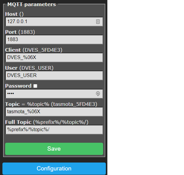

Both plugins need an individual topic for each module. You have a default topic "tasmota" and it doesn't work.
User and password must be what you have for mosquitto
- erem
- Posts: 230
- Joined: Tuesday 27 March 2018 12:11
- Domoticz version: 2021.1
- Location: Amsterdam/netherlands
Re: Flashed Shelly and now...
you show your mqtt host as 127.0.0.1
that is the loopback address of the shelly, probably not the mqtt host.
put in the real IP address of the mqtt server.
