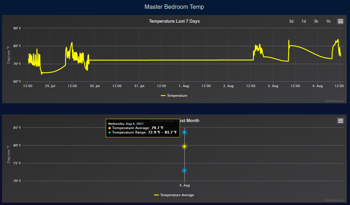

I am usign a MySensors USB gateway with a DS18S20 temperature sensor. I am running Version: 2021.1 (build 13369) on a windows 10 PC. Using the web interface to look at the daily logs works fine. The month chart and the year chart are only showing the current day's data. I do shut down the PC each night. I have tried downloading the log as a xls and I only get a single line of of data as well. This is the first and only device that I have used with Domoticz.
Can anybody help me trouble shoot this?

Month and Year Temperature log only showing current day
- temperature log issue.png (140.41 KiB) Viewed 809 times

You will have to leave the PC running 24/7 (all day long) as the month data is calculated at 12 o clock at night and stored in a different table.
Domoticz is a server kind of an application and not supposed to be stopped and started every day.
You perhaps better use a dedicated small computer like a raspberry pi to run Domoticz on.

Re: Month and Year Temperature log only showing current day
That is exactly the information I needed. I wanted to vet it out on hardware I already have before purchasing a Pi. Now I have the confidence to proceed.
