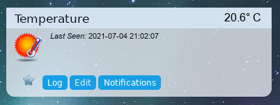

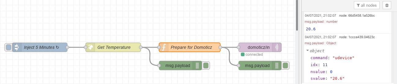

(It is really the most simple web scraping, I ever did)
See the screenshot below:
And this will result in:
If you have installed both Node Red and Mosquitto, you may want to import this flow:
[{"id":"53864ab3.6d5304","type":"tab","label":"Temperature2Domoticz","disabled":false,"info":""},{"id":"5490d5ff.8a5774","type":"inject","z":"53864ab3.6d5304","name":"Inject 5 Minutes","props":[{"p":"payload"},{"p":"topic","vt":"str"}],"repeat":"300","crontab":"","once":true,"onceDelay":0.1,"topic":"","payload":"","payloadType":"date","x":570,"y":160,"wires":[["eaf2f3b6.01dd48"]]},{"id":"eaf2f3b6.01dd48","type":"http request","z":"53864ab3.6d5304","name":"Get Temperature","method":"GET","ret":"obj","paytoqs":"ignore","url":"http://www.temperatur.nu/termo/abro/temp.txt","tls":"","persist":false,"proxy":"","authType":"","x":810,"y":160,"wires":[["66d5458.1a526bc","4fbd99e.7a945e8"]]},{"id":"66d5458.1a526bc","type":"debug","z":"53864ab3.6d5304","name":"","active":true,"tosidebar":true,"console":false,"tostatus":false,"complete":"false","statusVal":"","statusType":"auto","x":1030,"y":220,"wires":[]},{"id":"4fbd99e.7a945e8","type":"function","z":"53864ab3.6d5304","name":"Prepare for Domoticz","func":"msg.payload = {\"command\":\"udevice\",\"idx\":11,\"nvalue\":0,\"svalue\":msg.payload.toString()};\nreturn msg;","outputs":1,"noerr":0,"initialize":"","finalize":"","libs":[],"x":1060,"y":160,"wires":[["1ccce439.04623c","844c19c8.4eba3"]]},{"id":"1ccce439.04623c","type":"debug","z":"53864ab3.6d5304","name":"","active":true,"tosidebar":true,"console":false,"tostatus":false,"complete":"false","statusVal":"","statusType":"auto","x":1290,"y":220,"wires":[]},{"id":"844c19c8.4eba3","type":"mqtt out","z":"53864ab3.6d5304","name":"","topic":"domoticz/in","qos":"","retain":"","respTopic":"","contentType":"","userProps":"","correl":"","expiry":"","broker":"f9f13036.e28b58","x":1290,"y":160,"wires":[]},{"id":"f9f13036.e28b58","type":"mqtt-broker","name":"localhost","broker":"127.0.0.1","port":"1883","clientid":"","usetls":false,"compatmode":true,"keepalive":"60","cleansession":true,"birthTopic":"","birthQos":"0","birthRetain":"false","birthPayload":"","closeTopic":"","closeQos":"0","closePayload":"","willTopic":"","willQos":"0","willPayload":""}]
Do not forget to replace the IDX of the virtual temperature sensor with your IDX (currently 11).
