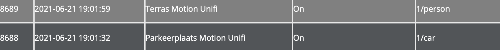

The sValue(s) can be any useful string. In my use-case there are motion sensors holding info about what triggered them. See screenshot.
I use these value's in notifications.

waltervl wrote: Monday 21 June 2021 21:02 I have no knowledge that a motion sensor in Domoticz knows and saves what triggered it. The screenshot you showed is not a Domoticz screenshot. Perhaps zwave?
Thats a screenshot of the Domoticz visual-editor's Devices-current-states page.
Natively a motion sensor has 1 value On/Off, but any type of device can hold as many sValues as you would like it to have.
In my case the (virtual) device gets updated by MQTT, motion On/Off (nValue) + trigger person/vehicle/animal (sValue). Next I use dzVents to send a notification with the sValue: "Person detected", "Car detected" etc.
