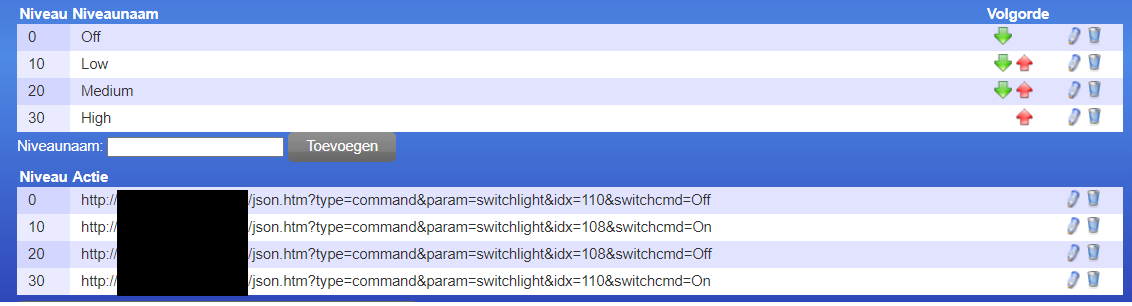

As above i used 2 virtual switches as on/off. These switch i'll access with a 4-button virtual switch.
- Create in Domoticz a new virtual switch as type Selector switch.
- Manage this switch in the switches pages and edit it as below:
At the end i programmed the Sonoff RF Bridge with a code of a virtual switch ARC K 13 / 14.
Repeatedly i just hit with the mouse the url and then ENTER. ( for 3 to 4 time quickly after each other)
