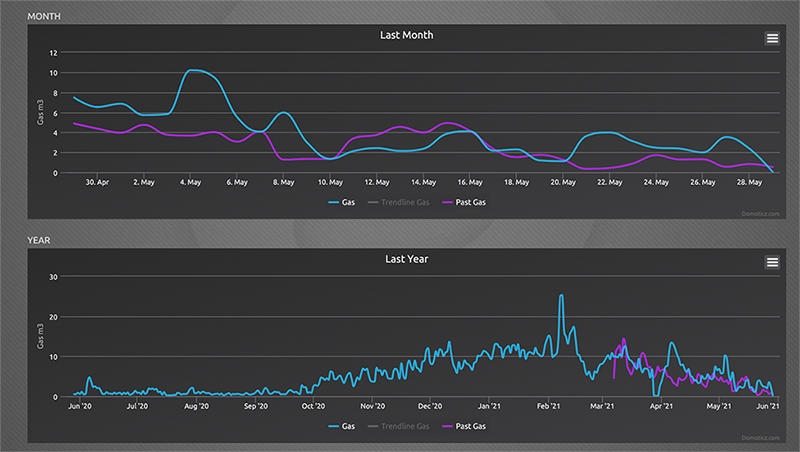

Domoticz has this feature in "Last Month" and "Last year" graphs that shows the values from the same month last year. I like this in my gas and electricity graphs that I get from my P1 smart meter as it allows me to compare my usage with last year's.
I have not found a way to mimic this in any Dasthicz graph. I have added a screenshot that shows what it looks like.
Any help or pointers would be welcome!

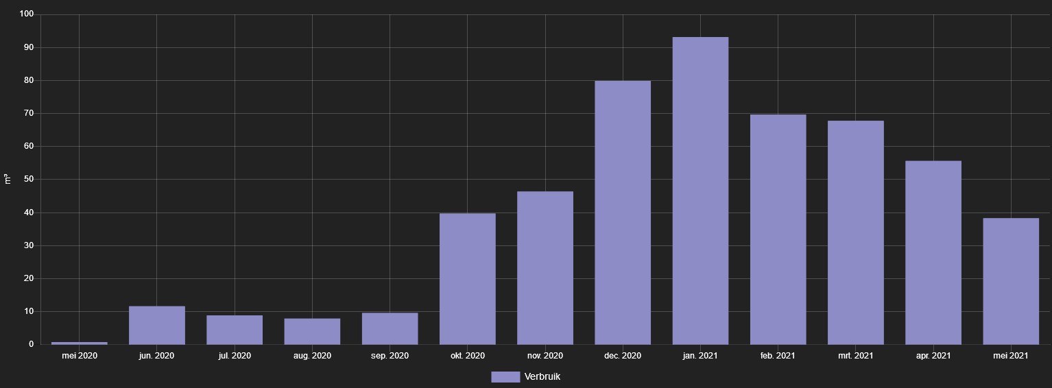

Naamloos 1.jpg (71.28 KiB) Viewed 719 times
Now it looks like I almost didn't use gas in May 2020, but the value is just from today date till the end of the month.
This is something else that stumped me for a while. But I realized (as you did), it just looks back *exactly* one year (365 days) which means that the first bar is no longer accurate almost immediately after it is displayed....
