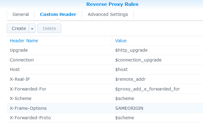

I did it like this with Synology I think there is a typo in the wiki
X-Forwarded_Proto => X-Forwarded-Proto

Fixed, thanks for reporting.hestia wrote: Thursday 11 August 2022 18:41 I think there is a typo in the wiki
