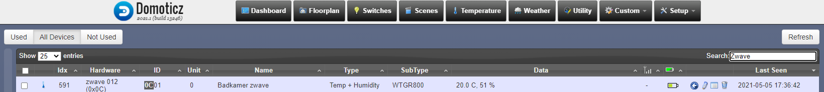

Yes. If you want to see all your zwave devices then don't select any hardware and type zwave in the search window on the devices tab.
Search window.png (51.65 KiB) Viewed 210 times
