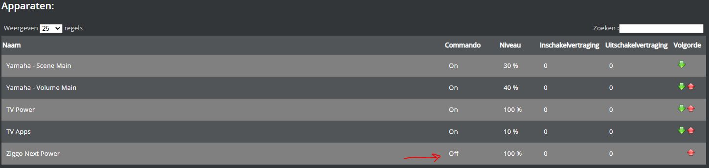

To control my AV System (TV, Yamaha Receiver and Ziggo Next Box) I have created 11 Scenes.
Scene 1: Turns On Receiver, TV and Ziggo Next (to the correct outputs)
Scene 2: Turns Off: Receiver, TV and Ziggo Next
The other 9 Scenes are not using Ziggo Next so they also turn Off the Ziggo Next e.g. Watching Netflix with TV App:
The problem is that the Ziggo Next Remote has a Toggle On/Off button.
So the Virtual On/Off Switch in domoticz, which controls the Ziggo Next box via Node-Red is actually a toggle On/Off button.
Now if I switch from Scene 1 to Scene 3 (Netflix) the Ziggo Next Box turns off correctly.
But when I switch from Scene 3 to one of the other Scenes (Except Scene 1), those Scenes also want to Turn Off the Ziggo Next...but it is already Turned Off by switching from Scene 1 to Scene 3, As a result the Ziggo Next is turned On (the Off Command in the group has no effect) again because it is a Toggle Button.
How can I solve this problem with dzVents?
Note: I also have created a Virtual Switch in Domoticz, which keeps track of the online/offline status of the Ziggo Next Box. (maybe this can be of use?)
