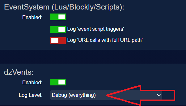

Draakje wrote: Saturday 24 April 2021 21:56 Where to look for clues?
A start would be to activate dzVents debug logging.
[setup][settings][other]
