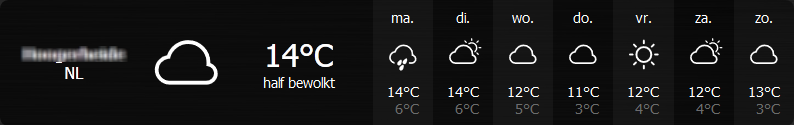

Is it possible to refresh OWM in the standby mode.
Now i need to refresh Dashticz to get OWM update. This is causing to reload Dashticz every hour to get the updated OWM on the Standby screen

Unfortunately the widgets are not a alternative.
I want have my screen as much as black as possible and the widget are too colourfull :roll:
The OWM icon are unfortunately dissapeared with the screenshot :shock:

Maybe weatherwidget.io an option?

Is it possible without the forecast of the next coming days ?

madpatrick wrote: Monday 19 April 2021 18:26 Is it possible without the forecast of the next coming days ?
Yess. You can customize the view.

The widget is working on screen 1, but not in the standby mode
I see only the location.
Same configuration is working normal on the screens
It looks that the <script> part is not loading in the Standby mode.
Is this possible ?
<a class="weatherwidget-io" href="https://forecast7.com/nl/51d834d13/hellevoetsluis/" data-font="Arial" data-icons="Climacons Animated" data-mode="Current" data-days="5" data-theme="dark" >Hellevoetsluis, Netherlands</a>
<script>
!function(d,s,id){var js,fjs=d.getElementsByTagName(s)[0];if(!d.getElementById(id)){js=d.createElement(s);js.id=id;js.src='https://weatherwidget.io/js/widget.min.js';fjs.parentNode.insertBefore(js,fjs);}}(document,'script','weatherwidget-io-js');
</script>

I think it's a limitation of the weatherwidget.
The weatherwidget is run only once. That means if you have a weatherwidget on one of your normal screens, then it's run before the standby screen is created, and the weatherwidget on the standby screen is not found...
So you have to choose: weatherwidget on a normal screen, or weatherwidget on the standby screen, not both.
There is no easy workaround.

Thanks Lokonli,
Now it is working !
It is only not so stable. Sometime it is not loading in the standby mode and needs a reload of Dashticz
It looks like to be an Fully Remote Admin issue
With Chrome Browser on my tablet it is working

I managed the to get the widget working on the standby screen, but it is also not updating hte weather information.
After a restart of the Dashticz often the weather information is lost and i see not widget
